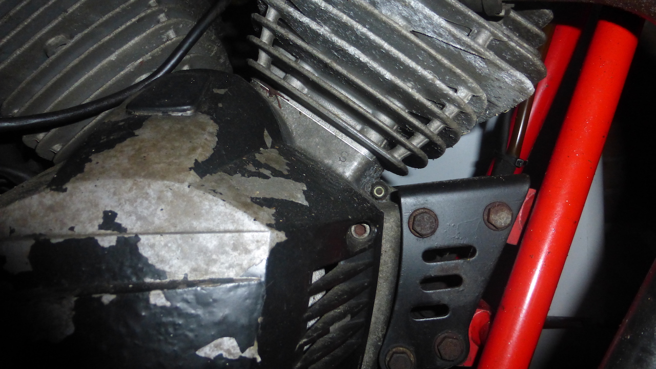

Have recently bought this. Although not an expert on Morinis, it does appear to be fairly unmolested to my eyes.
My first question is, Sport or Strada ?
there does appear to be an s below the barrel. However it does have Strada bars, not clip ons.

Hi, whatever it is it looks OK to me. It appears to be an electric-start bike (it's something becoming more and more desirable to 'older' owners :wink: ) and I imagine it's a later model.
Someone will be able to confirm, you could maybe get a ball park date from the frame number listings on the Dutch Morini site.

This looks like a mixture of diferent models.
The frame, side panels, mudguards and wheels seem to be from a K-model, the seat and tank obviously not

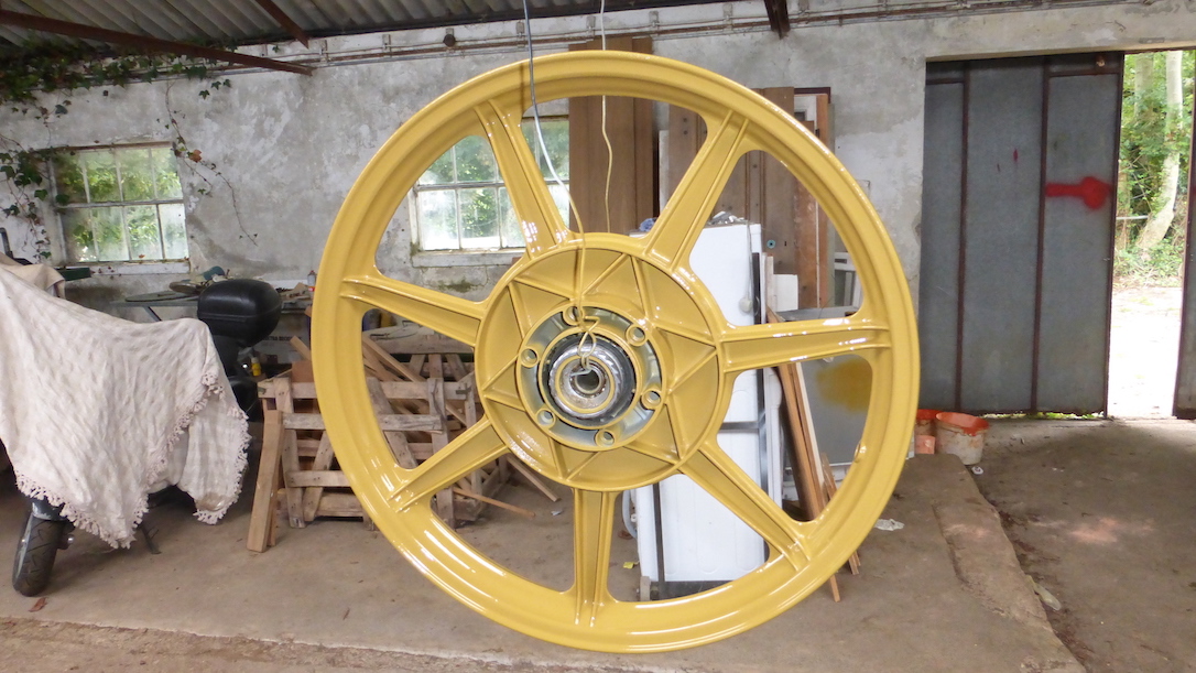

had some shot blasting done etch primed and managed to get a fresh coating of baby sick yellow on the wheels today
