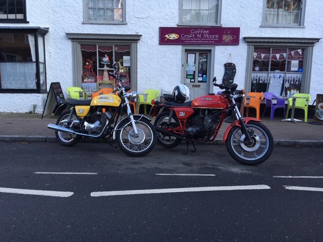

Posted: 02 Dec 2019 15:22
by Stubaker58
e
Mines the red one.

Posted: 03 Dec 2019 10:04
by mbmm350s
Nice picture, thanks for sharing. So glad the noise was something easy to fix!
If the insulation under the tank is the correct thickness then the line of the seat trim and the line of the tank pin stripes is smooth and continuous just like yours is, which makes it more aesthetically pleasing.
