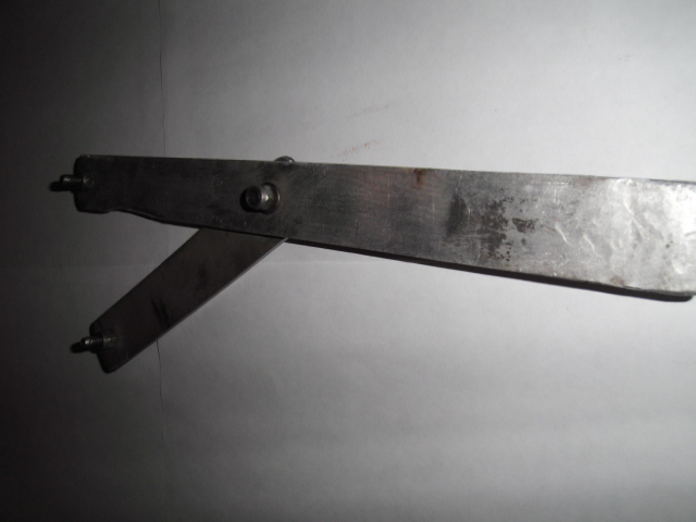

How do you guys prevent the rotor from turning when undoing the nut, do you all have the special tool?
Re: Cam Belt Size
Posted: 17 May 2019 19:28
by norbert
You can make that tool easily yourself. Two pieces of steel or strong alu, three screws and three nuts
Maybe you have to tune the two srews/bolts that enter in the flywheel (this one is for the newer flywheels). Leave one arm long enough to settle un the footrest :wink:
On the road you can put the 6th gear and juse the rear break.
