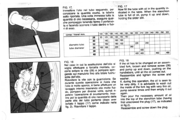

Hi I've just changed the fork seals ,how much oil should I put in ? Saw in 1 post that it's 450gr but not sure what that's in ml? Cheers

I have a Kanguro x the first drum brake model but don't have a manual.
Does anyone know what grade and volume of oil I should put in the front forks?
Fork oil.png (263.58 KiB) Viewed 15623 times
Check fork diameter and travei, then cross check the chart.
