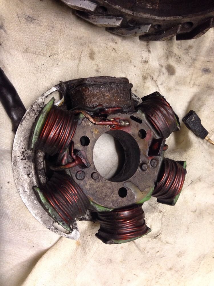

So it will be a "bodyless" stator, with the wire wound directly on the steel-plate-paket. It´s the strongest one with about 200W
körperlose Lima.JPG (136.42 KiB) Viewed 10362 times
Cannot find a better foto. This one is quite uggly. Only the ignition coil has a plastic body (this one burnt)
So probably you also have one of the strongest flywheeles (number ending in ...97 or ...98)
With this altrnator and flywheel you won´t have problems with light etc. It`s charging the battery with the motor at idle :wink:
This stator you find in the pre Kokussan 501 models, late Kanguros (X3, don´t know if also X2) maybe also 350 Customs and K2 if they don´t have Kokussan. Perhaps in all models of the Cagiva time if not Kokussan?
With more than 180 Ohms between the green cable and ground there should be no problem starting the motor.
