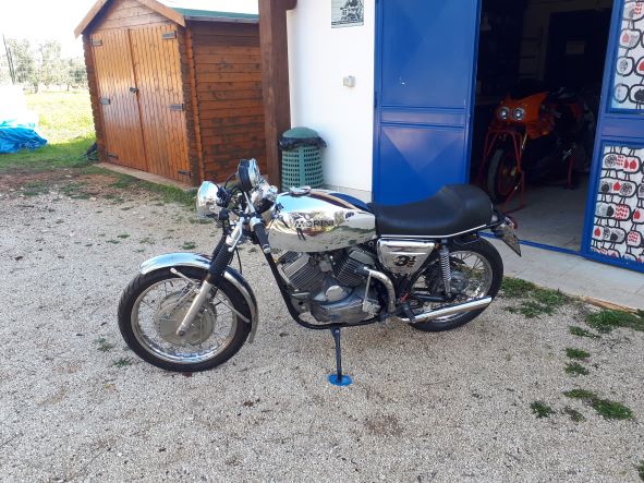

I have recently moved to Italy from UK and am slowly restoring and registering my bikes over here. I have had no problems getting CoCs for the Laverda and Moto Guzzi as I simply wrote to the Manufacturers directly, or Piaggio in the case of the Laverda, and they sent me the required documents for a price. fair enough I say.
I am not having much joy with my 1976 Morini 350 Strada as Morini are not replying to my requests and none of the online sites (that deal with this sort of thing) list Moto Morini as an option.
If anybody has found a way to get a CoC to import from UK to the EU or Italy specifically I would greatly appreciate your help.
