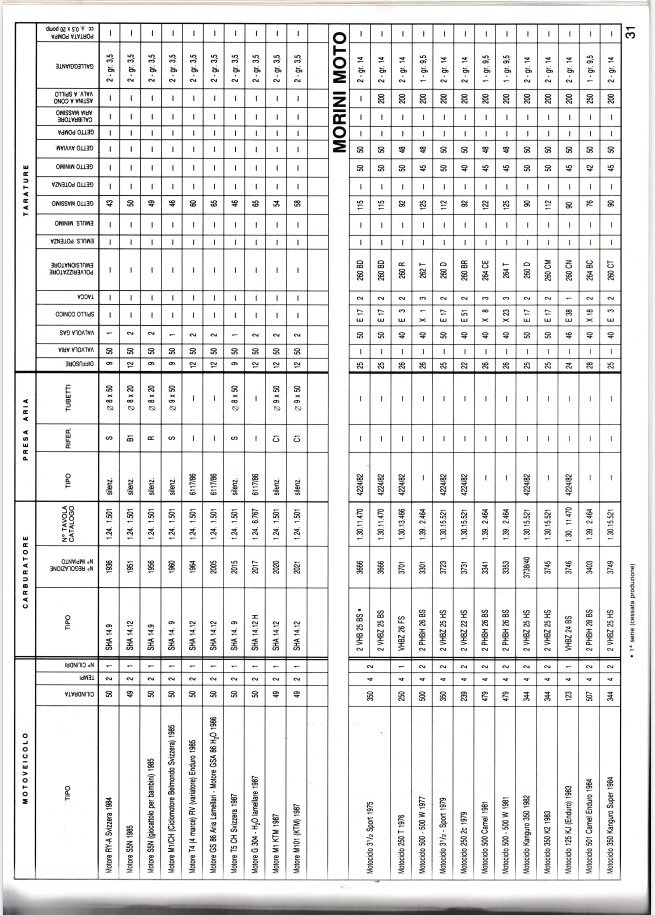

Is this useful - it should give yoy the Jet sizes at least. Eurocarbs should have all the parts.
Barry
Barry

There is a table on page 38 of the blue book which lists all the carb settings for various models. That’s a good starting point, but you may find like many that with modern fuels, wear and non standard parts (especially exhaust syetms) the settings as they were in 1975 may not be exactly as you will find you need.
Commonly people are fitting leaner pilot jets to get around excessive richness off idle and that has certainly improved mine.
