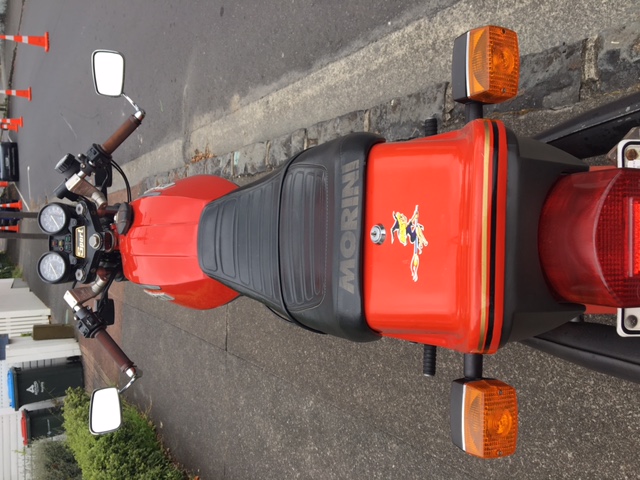

I'm going to have to get one of those 'witch on a broomstick' stickers for Mrs GB :lol:
