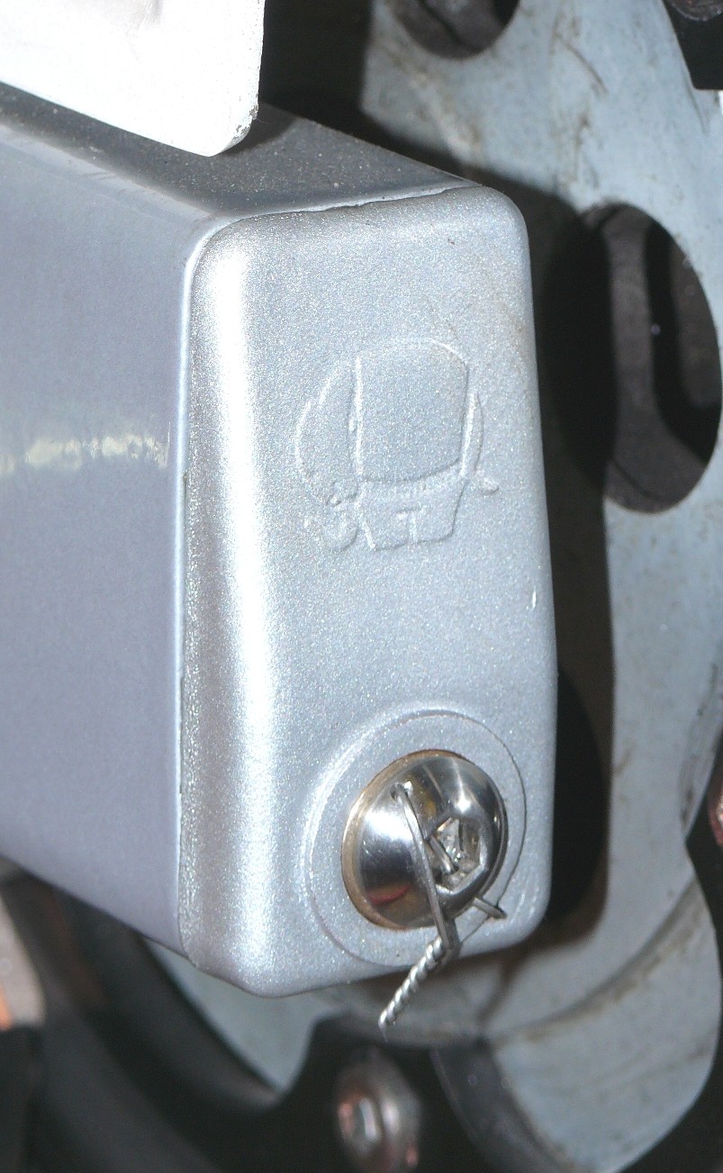

Since one of the plates on my Dart consisted of a nasty bit of angle-alloy, it's obvious that a PO either overtightened the bolt, smashing the plate, or had it come loose and back right out, letting the plate go free. This fault is common to many Ducatis, and the worst-case scenario is that the plate twists and locks against the sprocket, damaging a whole string of bits quite apart from causing the rider problems! On my ST4, I've wired the bolts to the plate and the arm, so I've done almost the same with the Dart.
I replaced the adjusting bolt with a long (80mm approx) stainless mushroom-head cap screw that, unlike many available bolts/screws, is threaded all the way. To raise the head out of the rebate in the hole, I turned some little spacers in brass, and the head of the screw needed a tricky bit of drilling for the wire. The plate was drilled at the point where it is cut away underneath for drainage, which just about allows a thin wiring-wire to got through it. In this case, I didn't drill the newly-powder-coated arm as if the screw can't come undone, the plate can't come free!
The screw I chose has a 5mm hex socket in it, so cannot be tightened as much as the original, but this can only be a good thing so long as it doesn't work free. Ultimately it's the wheel-spindle nuts that should be holding the wheel, and we're not talking mega-torque with this motor...
Nick
Nick
