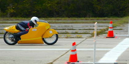

Well, my Morini Dart 350 is now ready for the Bonneville Salt Flats. I still need to figure out video camera mounts but the bike is ready. Image
As you can see I finished my paint job and graphics. Compare this to the pic above in Ohio last month. I used the windscreen generously donated by Tom to cutout an actual window for view in my tuck position. The tinted plastic is from a helmet faceshield. The handlebar mount to replace my cracked one also came from Tom. Thank you, Thank you. I installed a steering damper donated from my LSR friend Eric. It mounts to the left fork and then the body mounts to a bracket I made attached to the left upper crossbar bolt. So no holes drilled in frame.
By the way, my Moto Madcap logo is a parody of the Moto Parilla logo with their racing greyhound. My wife made a cartoon sketch of one of our Pyrenean Shepherds and added sunglasses. I will also be taking my Parilla 175 to Bonneville and I just fired up that engine today after three years.
I will try to update from Bonneville. Thanks again to all who have given their help on this adventure. This will just be phase one.

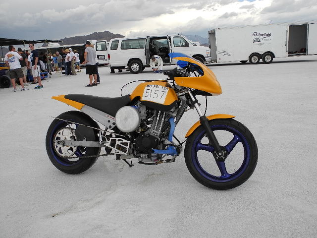

Here is a shot from this past week at the Bonneville "Speedweek" event of a turbo-charged Buell 350cc bike that I'll be up against when I get there next year...
I think it went 116 mph with not very much of a fairing...Fast bike...

Did Buell ever market a 350 then, or was this a one-off with the Harley motor in a Buell twin chassis? The Harley single (can't remember its name; possibly Bolt?) never made it outside the US, I don't think. I like quirky singles.
Nick, UK
PS OK, done my homework a bit and now remember the Buell Blast; a neat-looking 500cc thing that Erik B famously crushed because he was embarassed by it not being macho enough! If it was like the Buell Ulysses-variant I rode once, it was an interesting chassis fitted with a dog-of-an-engine. As with all modern-day singles, it was doomed. Plenty of people here and in the US say that's what they'd really like (neat, light, good handling, good mileage,) but too few of 'em actually buy them.... :roll:

The Engine is most likely De-Stroked or Sleeved to get to 350cc or they are using a cylinder and crank from the 750cc "flat-track" factory racer...
As the single is based on the "Sportster" V-twin motor, there are plenty of aftermarket and factory hop-up parts available....
Not a bad way to go really, and the Buells hold most of the pushrod records right now...
I say most because the fastest bike on record is a Harley Sprint (AERMACCHI single) built by Tim Cryus. It has gone 122 mph without a supercharger or nitrous...
A really fast bike !
Our Morini's should be able to equal and then beat them, but it is not a "Given". It will take a real effort to do it...
Robert in California

***CORRECTION** Buell Blast w/turbo not so fast after all.............
It seems the owner/rider of the Buell Blast had two bikes entered at Speedweek. The 350cc and a 750cc bike. The 750 went 116 mph not the 350....
After looking at the daily run logs from the event, the 350 made three runs and only made it through the 1/4 mile timing trap each time before turning off...
Best speed recorded was 54.3 mph,,, not too impressive to say the least...
Sorting out a turbo on a very small single (turbos like LOTS of exhaust pulses to work well) is not an easy matter, and is not for the faint of heart....
As an old racing crew-chief, I can sympathize with the issues he faces.....but my Roots Blown Morini will have no mercy on the Singles once it gets to the Salt...
