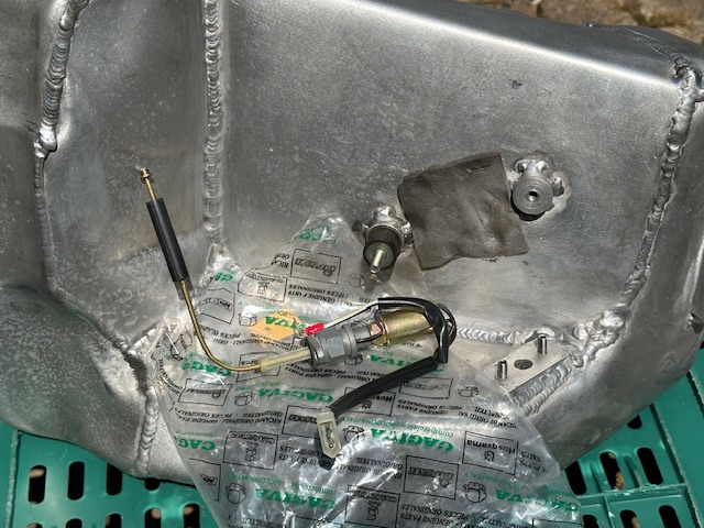

Today marks possible extinction of the species for dart fuel taps- I have just fitted what might well be the last new old stock one in existance. As my 501 dart is my forever bike I was hoping I wouldn’t have to use it so soon, but we’ll see how long this one lasts.
It was particularly nerve racking for me as the standard tap orientation pointing forwards does not work for me (too close to the cylinder head which is of course taller with a 500 engine.) so I have to carefully bend the brass tube 180 degrees so I can fit the tap the other way round.
