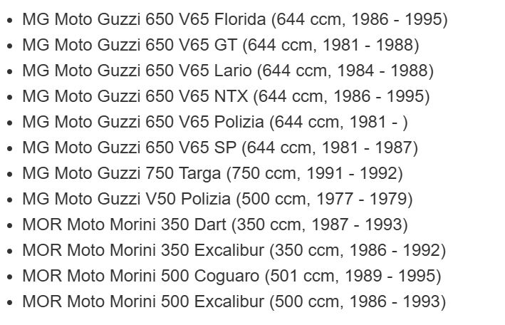

Re: Dart 400 Brake Calipers - repair kits?
Dear Tom,
Yes, that's right, I found that out too. The rear brake caliper on the Dart was also used on many other motorcycle models (=> see picture, list incomplete). The Brembo repair kit has the number 39659000-Z.
![Image]()
Warm regards
M.P.
Warm regards
M.P.
