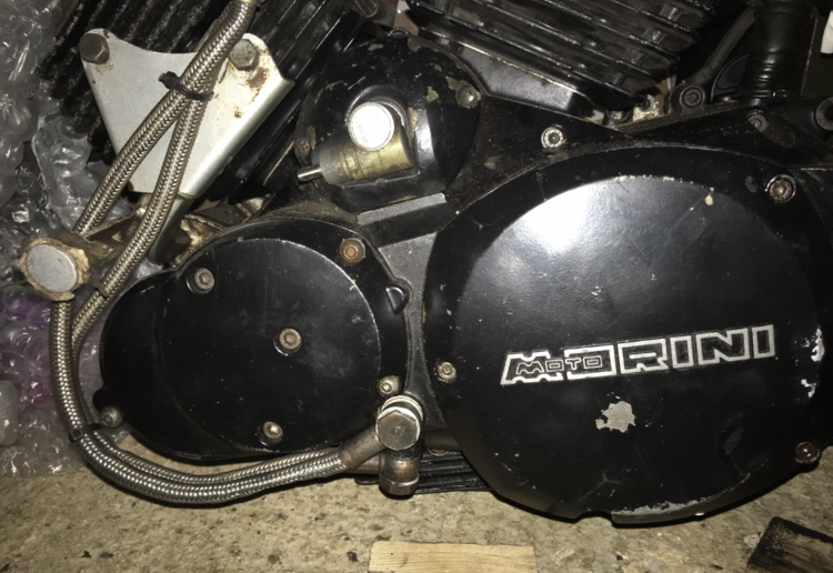

The dart has the later (kokusan era) casting, as per the New York and late Excaliburs, with the starter motor in front of the engine. Not sure that cover would fit in a kanguro as your down tubes will be in the way. That said, coguaros used the late type cover.
Only the darts had oil coolers but the customs and coguaros just didn’t have the bosses machined through on their castings.
The internal oil galleries are not much (at all???) different to the earlier style cover as you have on your kanguro. It wouldn’t surprise me if a bit of machining and welding couldn’t break through in the right place- of course the oil pressure switch boss would be one of your tappings.
As regards oil pump, I don’t believe they did anything different for the dart to compensate for the oil cooler. It was a well s spec’d pump in the first place.
If it’s any help I can take some pictures of the inside of the cover so you can see where the dart oil cooler banjos break into the gallery.

Dart engine left side photo:
Let me know if you want to see what it looks like inside that cover
