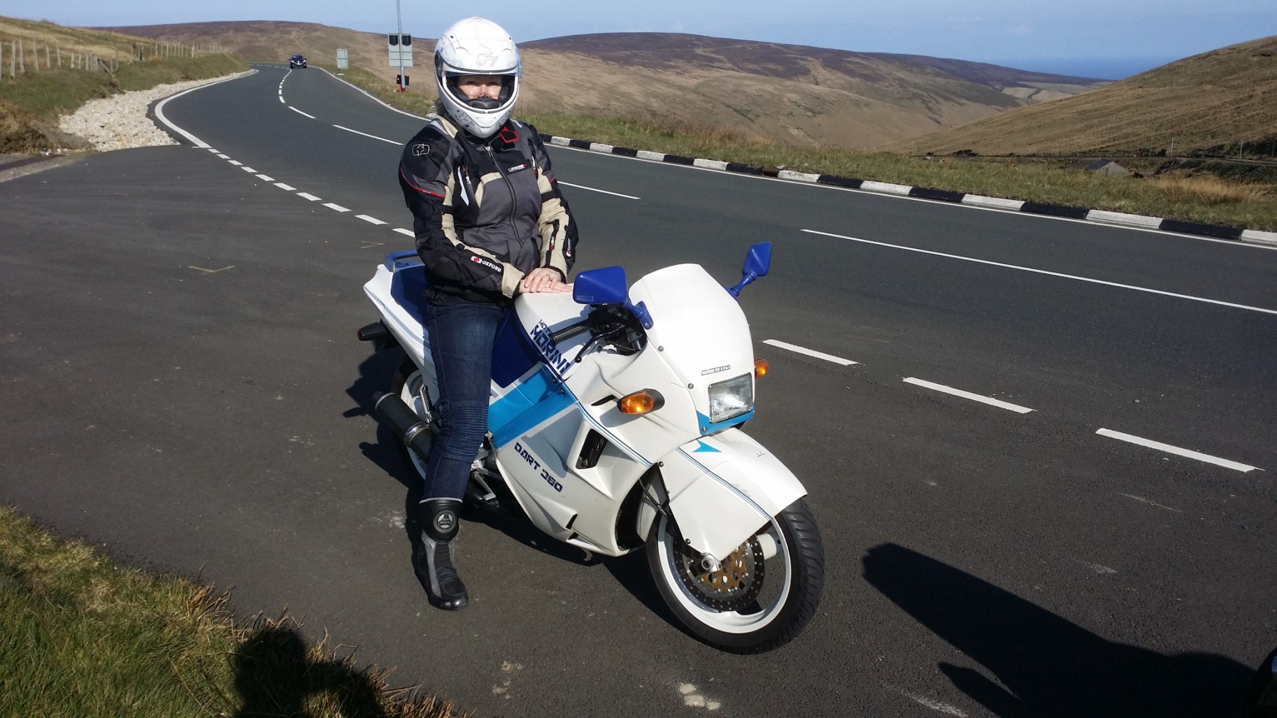

Hello, I am new to this forum and a new Morini owner having just bought a 350 Dart for my wife.
She loves the bike but would like the handlebars to be higher to take the pressure off her hands, have any other Dart owners ever found a way to rise the bars?
