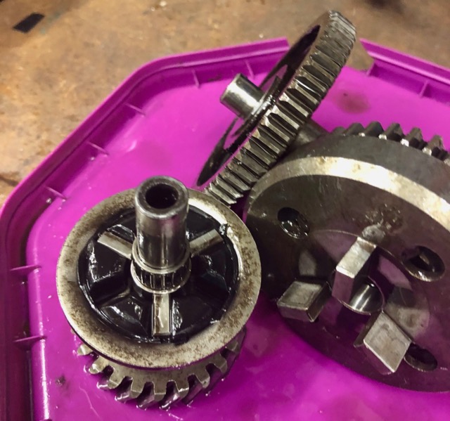

Not Dart but same starter system on Coguaro
Investigating slight whine from starter gearing.There are 4 shimwashers ,item 10 on the exploded diagram. In my case 2 are 0.95 and two are 1.5mm. Is this by design? At the mo the thin ones are in board. Looking at witness marks has not clarified the correct sequence. One fatter shim on the gear meshing with the starter has a noticeable wear ridge.
Thought about polishing it out.
What to do?

by morini_tom
The thrust washers are all listed with the same part number (part 10 on the dart parts diagram), and no mention of different sizes available.
I have certainly never noticed any of any different sizes and I've had a fair few apart! And they are pretty hard and I've never seen any wear on them.
I will measure up the thrust washers I have in my dismantled engine and let you know

Posted: 09 Sep 2020 17:32
by morini_tom
All four are 0.95 in my dart motor, so it does appear that your 1.5s are wrong.
I have another motor in bits if you want a third opinion but that’s much harder to get to.
With the thicker thrust washers you’ll be loading up the assembly when you tighten the cover, as I don’t think there is intended to be any end float. Maybe also causing the sprag clutch to not be able to freewheel? Would be worth checking the condition of the needle roller thrust bearings incase they’ve been damaged.
How thick is the gasket on your cover? should just be a normal thin (~0.5mm) paper one. If a thicker gasket has been used then maybe thicker shins were used to compensate. But it’s not the right solution. The dart engine I have in bits had one gear in the starter cluster which had moved outwards on the shaft, and to prevent it locking up when the cover was tightened, somebody had fitted a 1.7mm thick gasket. Again, not the right solution.

Posted: 09 Sep 2020 21:57
by morini_tom
I would say they are probably hardened and polished thrust washers, and matched to the needle roller thrust bearings- don't forget the sprag clutch cluster is permanently driven by a helical gear and hence the thrust bearings on that gearset, and one half of that shaft at least is always turning.
I just measured mine- the shaft is 12mm diameter and the thrust washer is measuring accordingly at 12.1mm diameter. The OD of the washer is a slightly odd 25.8mm (1 1/64"?)
Looking at the outer cover and gearset I see no reason why you couldn't go slightly bigger on the thrust washer OD if needed. You can't go smaller or the needle rollers would be at the edge of the thrust washer.
The 0.95mm thickness seems to be the tricky bit- I had a quick look at online bearing stockists and couldn't see any 0.95mm thrust washers. But a more thorough search may yield something.
Closest I could see is an SKF thrust washer at 12x 26 x 1 mm https://www.bearingstation.co.uk/produc ... x1mm=46694
I imagine that the 0.05mm thicker thrust washer will be insignificant, and you can split that by using your two 0.95mm washers on the inboard shafts and the 1mm shims on the outboard, as opposed to both 1mm on the same shaft.
