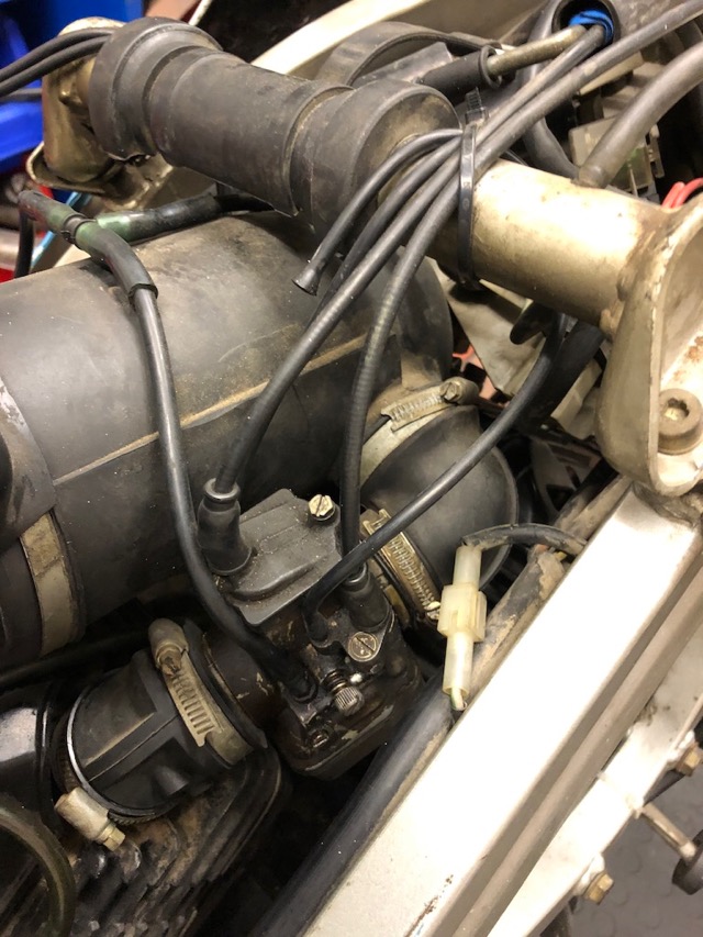

Does the lever look like this?clanger9 wrote:My Dart is a pig to start from cold. It feels like the choke lever isn't having much effect.
The carbs are balanced, the mixture & timing is set and the bike runs perfectly once it's started.
It appears that the choke lever only works on the rear carb. Is this right?
Where do I need to start?
I read something about replacing an o-ring in the carb - presumably take the rear carb off and have a look?
No idea if that's OEM, but the seller of that says:
Moto Morini Dellorto Choke lever. This is the choke lever control unit for various Moto Morini bikes, the lever is flipped which pulls 2 cables which can be added to the opposite end. It is meant to operate the choke on dellorto carbs. This unit is black . Made in Italy

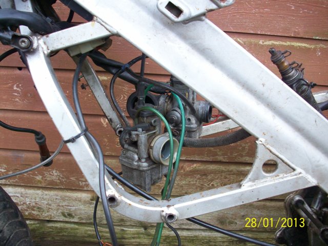

Hello, on the Dart I had there was a flip up choke lever on one carb and the other carbs choke was operated by cable from the left handlebar.
If I had kept the bike I would have used a cable splitter so that both chokes were cable operated from the handlebar.

The Dart should have a choke lever integrated into the left hand switchgear if I remember, which operates both carbs.
Check plugs and leads, too. If original, get some nice copper core leads and NGK caps.
How clean is the air filter?
Re: Poor starting from cold
Rear carb only.MickeyMoto wrote:The Dart should have a choke lever integrated into the left hand switchgear if I remember, which operates both carbs.
One enrichener is normally enough, but if you really need it you can reach in through the side panel vent and flip up the manual lever on the front carb.

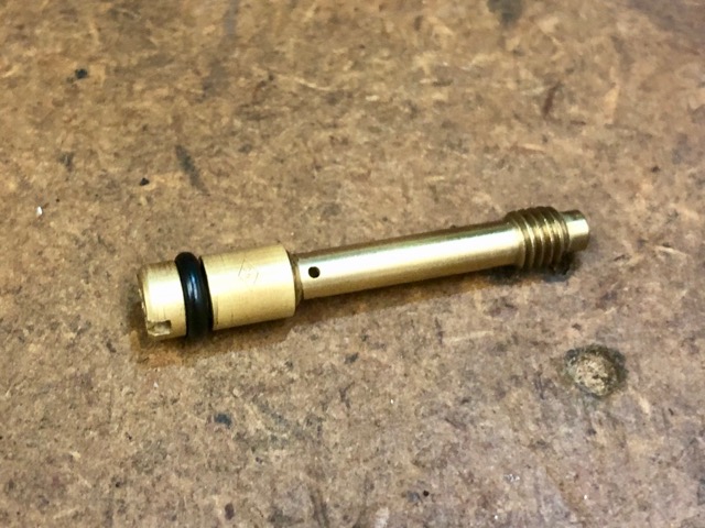

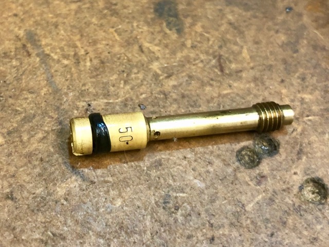

All fixed now!
I stripped the rear carb and found a perished o-ring at the base of the choke jet: Replaced with a new o-ring and it now starts fine from cold:

The act of removing the starter jet probably dislodged the debris that was blocking it. The O-ring has no effect.
That makes sense - I couldn't see what the point was of the o-ring!
To hold the float bowl on whilst you search for the main jet holder!clanger9 wrote:That makes sense - I couldn't see what the point was of the o-ring!
"Possibly the starter jets are actually at least semi-blocked with gunge."EVguru wrote:The act of removing the starter jet probably dislodged the debris that was blocking it. The O-ring has no effect.
Sh1t in the carbs - always near the top of the list for poor starting on anything

I agree - though (surprisingly) the carbs were spotless inside. I couldn't see anything in the choke jet, but it could easily have been a bit of unleaded gunge that wasn't visible.
Anyway, it's fixed now...
