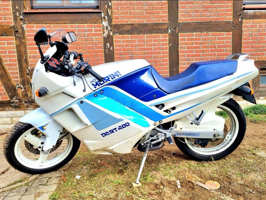

Hello - first post, so please be gentle! I'm recommissioning a Dart that's been off the road for the past decade or so, and hit the first milestone today when it fired up for the first time. I put 2.5l of Motul 10W-40 in there to start with, as that seems to be the accepted wisdom. However, the oil pressure light stayed on. I'm 99% sure that this will be down to the sensor, rather than actual low pressure - but is there an easy way to test this? Is there a gallery or something I can access to see if there is pressure?

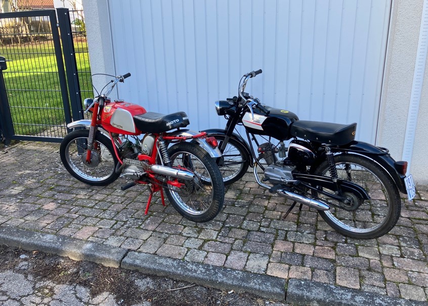

I registered here today and am delighted to be part of the club. I am Matthias (model year 1969) from Leonberg in Germany and have owned two small Moto Morini Corsarino for a while now - they are a lot of fun. My latest addition is a Moto Morini Dart 400, from a Morini collector from northern Germany (Armin Prinke), who sadly passed away last year. As I would like to exchange ideas with others about the technology of the motorcycle, I searched and found the club. I already have my first question about the Dart: As already mentioned several times in this chat, I also fell for the oil level warning light, as I also thought it was the oil pressure. I was shocked when the light didn't turn off the first time I started the engine. I like EVguru's idea of installing an oil pressure switch in the oil cooler line. Does anyone from the forum have a recommendation for a suitable adapter? Or do you know which threads the oil cooler connections have? That would be super helpful.
Many thanks in advance and best regards from Leonberg

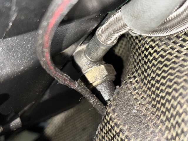

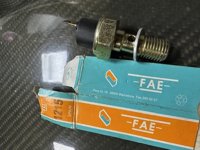

On my dart I fitted a pressure switch and it was very straightforward.
Peugeot 205 MK2 1.4 1987-1998 FAE Oil Pressure Switch #1215 is an almost straight fit in place of the original lower oil cooler line banjo.
The Peugeot pressure switch has a smaller diameter bore so I drilled it out to match the dart original so as not to restrict oil flow. It is also ever so slightly longer so I used two sealing washers instead of one to space it.

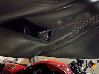

Other than that, it’s a straight swap in, and even clears the bodywork (it will stick out of the lower air scoop slightly).
You will need to create an electrical contact to go to the instrument cluster. You could just use the oil level warning light wire instead of the oil level warning. On mine I decided to use the sidestand warning light so I removed and modified the wiring to the sidestand switch.

WOW! Tom, thank you very much! How you found this out
? That looks perfekt. I`ll use the oil-level-indicator light for the oil pressure, like assumed before.

A lot of measurements and a few wrongly purchased parts but I found the right one eventually!!!
If you use the oil level light then keep in mind that the neutral warning light tees in so that when in neutral the oil pressure light will come on as well (bulb check). This is useful (to check the bulb) but does mean that you can’t confirm if you have oil pressure in neutral which is not ideal. My advice would be to remove the connection between the two (just running a new wire is the easiest way as the join is in the main wiring loom) so that you can check for oil pressure even when in neutral. Bulb check of course is easy when the engine is not running!
Hope that makes sense but the Dart wiring diagram (in the back of the owners handbook) should make it clear

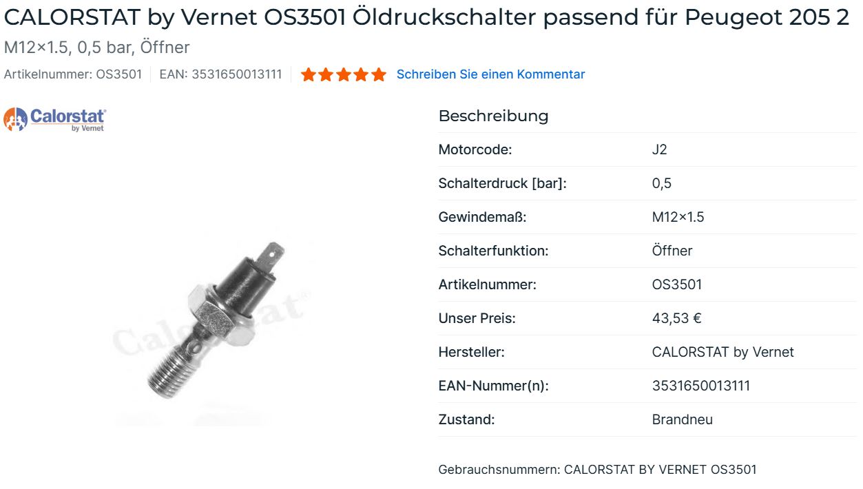

Yes, indeed. I'm going to lay a completely new positive wire from terminal 15 to the red oil light and the oil pressure switch switches ground on and off when the oil pressure is present, then the light goes out.
Unfortunately, I couldn't find the FAE sensor for sale anywhere, for the Peugeot 205 II I am shown this switch from Vernet, which should be identical in construction.
Warm regards
Matthias
