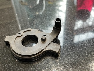

Hi all - I've been meaning to ask this for ages, but for whatever reason just never got around to it... The choke control on my Dart is broken at the handlebar end. I can still start it OK, so it's never bothered me that much - but I'd like to fix it if I can. Does anyone know if the same handlebar fitment was ever used on anything other than the Dart? Or something else that might be compatible?

Cagiva freccia. You’ll find a lot of the cycle parts are common with that.
I’ve probably got a spare choke lever, what exactly is it that’s broken on yours?

Oooh, yes, of course - I'll do a bit of searching for one. What has happened is the sticky-outy-clippy-bit that secures the end of the cable has gone missing:

Yes, I have a spare one of those Neil.
Send me your addess in a PM and I'll stick it in the post to you
