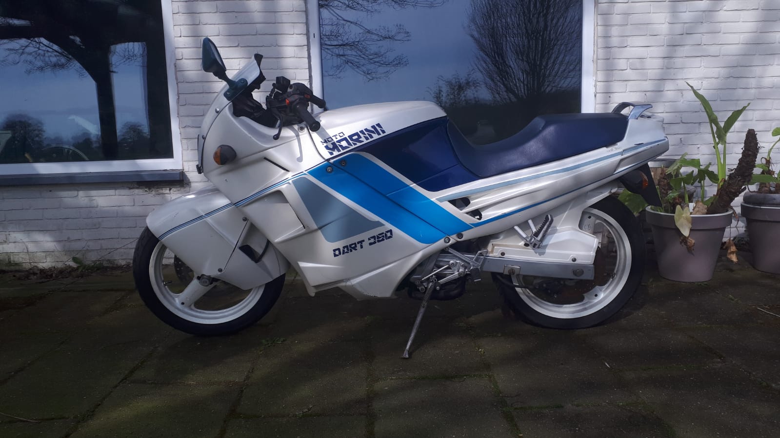

i just couldnt resist the temptation , this will keep my 350 sport and camel company. 8)
there is still quite a lot of work to do on it , on the other side the fairing is smashed,
finding a used panel in unlikely, so i can try my hand at repairing fairings.
i've always been curious how these handle, i'm soon going to find out.

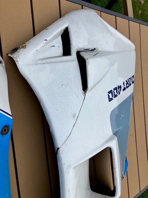

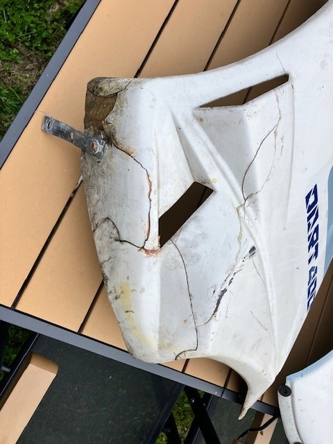

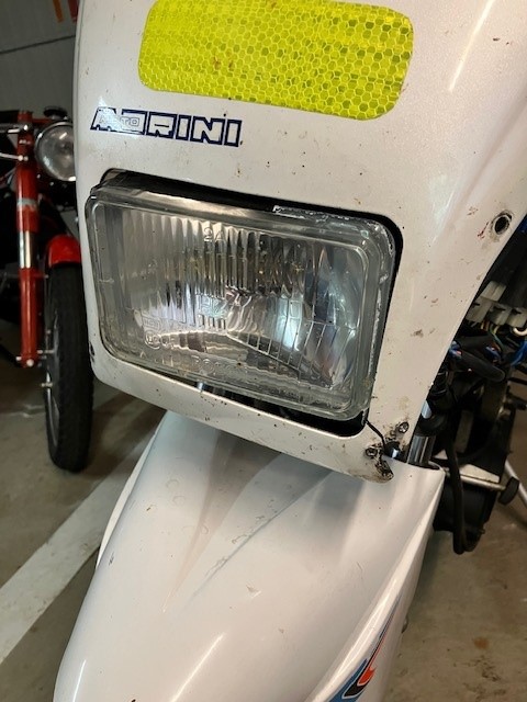

I'm new to the forum today, I'm from Germany, recently bought a Dart 400 and have already had some great advice and help with an oil pressure switch issue from Tom in Northampton. When I was looking to buy my first new bike in 1994, the Dart was top of the list, partly because it was so reasonably priced. Thanks to a donation from my grandma, I ended up with a Ducati 750 Supersport, but the little Dart has stayed with me ever since. At the beginning of this year, I actually found a Dart in northern Germany. It was the daily driver of a Morini collector who unfortunately passed away. The Dart runs well, now has 42,000 km on the clock and the fairing has been patched up. I have four questions for you:
- Here are a few pictures of the condition of the fairings. What do you think?
- Are there any reproductions of the fairings available? There was something here in the forum, in a post from 2023 (=> see quote above)
- Does anyone still have the rear part of the front fender for sale? I find this look even more striking.

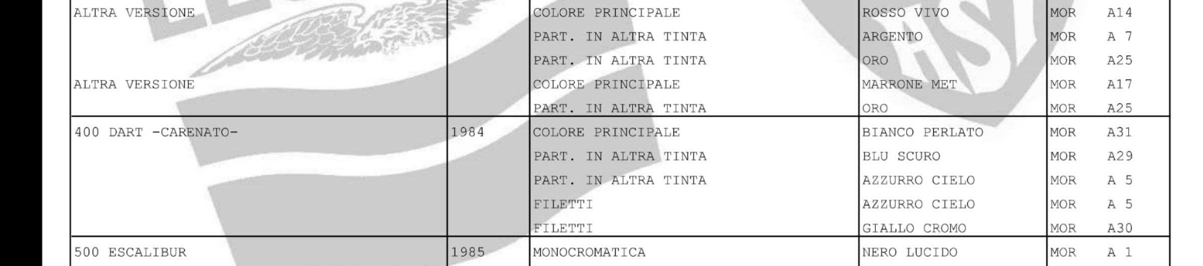

The basic color of the Dart (white metallic) reminds me of the Honda color Pear Shell White NH121. Does anyone know what the original Morini Dart color was called?

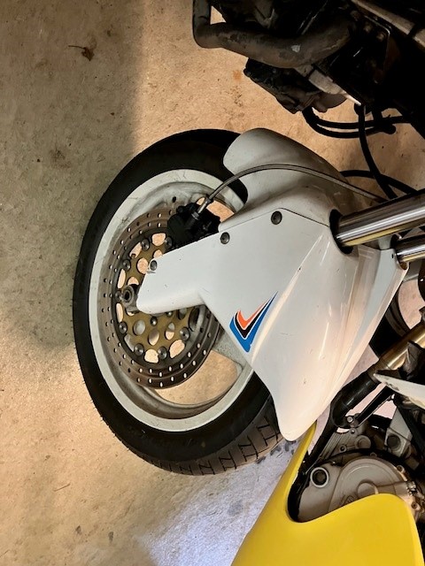

Thats the small rear part of the front fender on my Dart :D

Here you can find the originale colur codes from Lechler

Wow! Very helpful. Thank you.

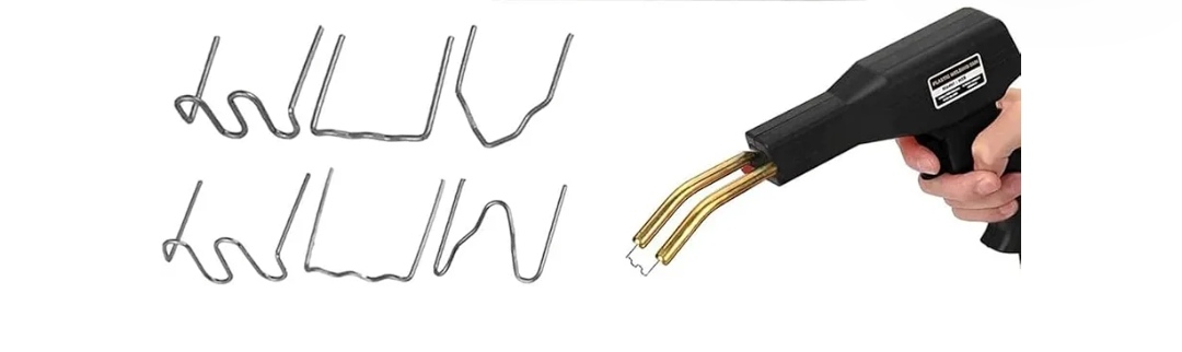

the fairing on my dart is damaged in exactly the same places , and and not easy to repair , as the plastic has become amazingly brittle.
i bought one of those aliexpress plasic repair kits , where you can melt stainless wire into the plastic.
that makes repairs a bit easier.

Dear Huub,
thank you, I also bought this plastic repair kit :lol: . I will reinforce the inside of the fairings also with fibreglass, if you roughen the ABS plastic well, then the resin will also stick to it. I will report back and upload pictures here in the forum.

Hi guys i repaired some Deep cracks on my dart fairing with some metal reinforcement, cianoacrylate glue, special Power and primer, here in Italy we can found a complete kit for this job, usually Is cheap around 40 euros, It Is important tò clean perfectly the surfaces, then reinforce the fairing with hot metal and then clean again and glue the parts i can shop pictures in the next days

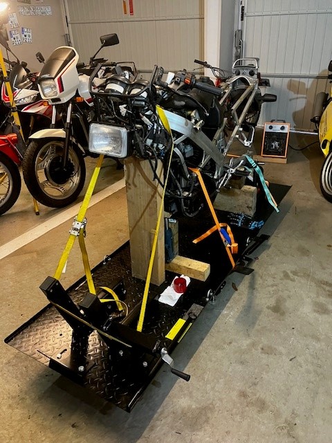

Good evening and warm greetings from Germany. Progress on the Dart is slow, but the panelling has been repaired and is now being painted 🤗. Just a quick sign of life.

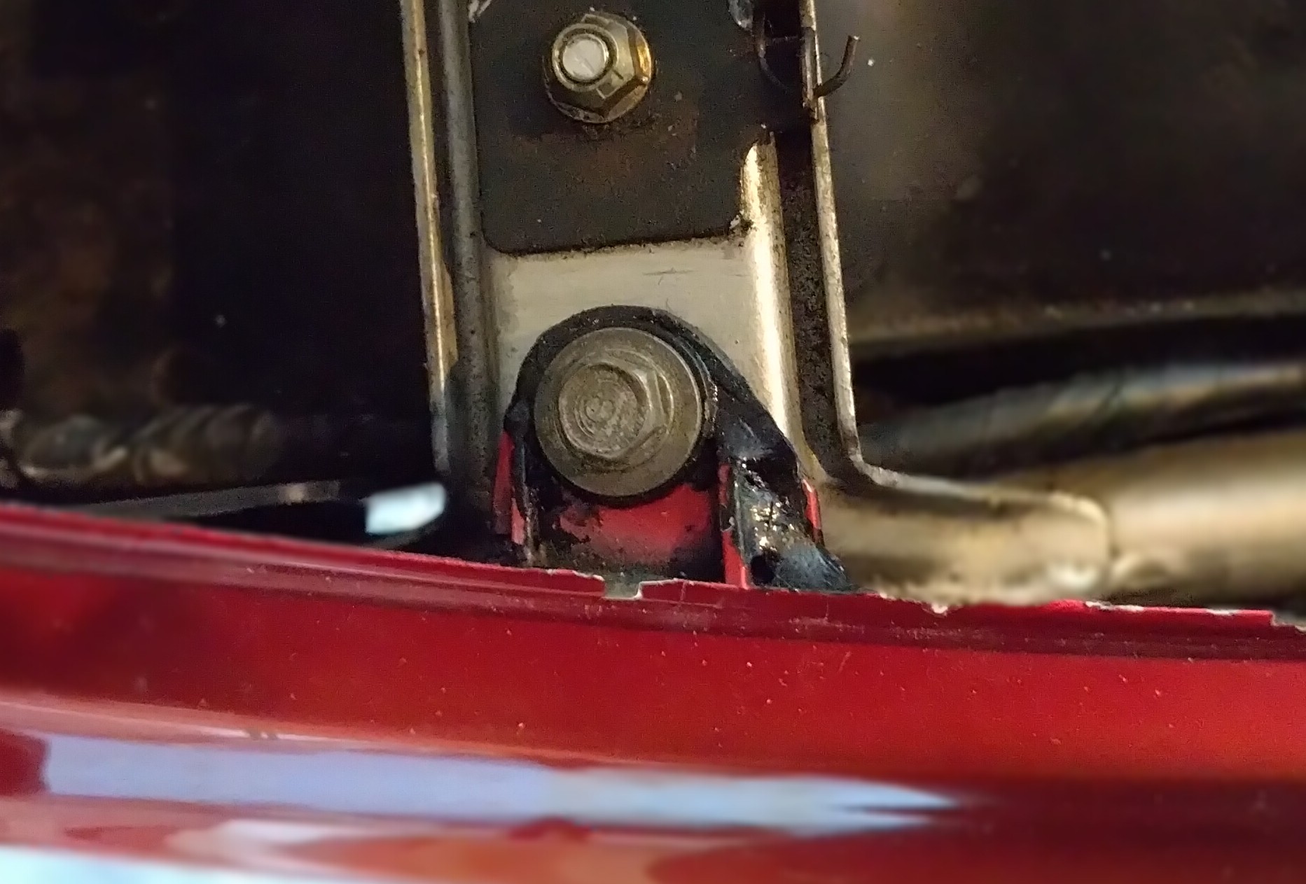

On my honda 400 I successfully repaired part of the broken seat cowl tab using A.B.S. slurry. Mix chopped up A.B.S. with avetone to make a gloopy glue. Shrinks as it hardens so may need a few layers building up and needs a day or 2 to fully harden. The black bit under the nut:-
Has withstood having a rubber grommit fitted and been back on the bike for a number of months.
