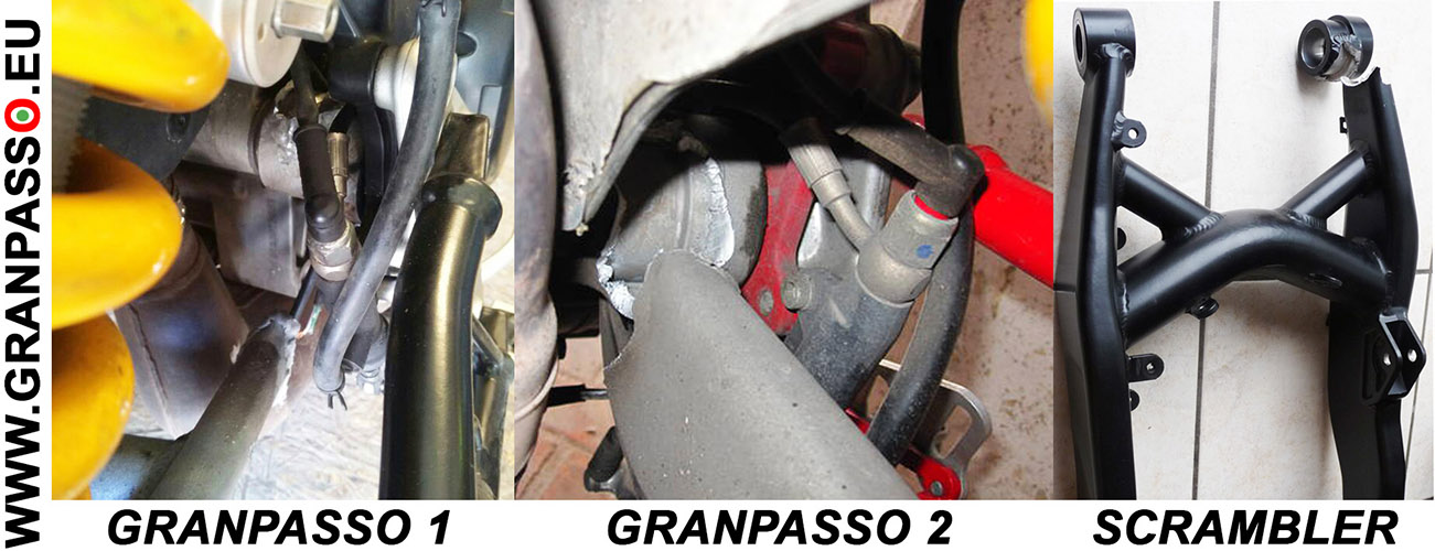

Hello, I'm Maurizio from the italian GRANPASSO.EU forum.
In important that you check your swingarm (Granpasso, Scrambler, 1200 Sport) and look for fractures, because it could break near the ohlins shock.
The university of Stuttgart, Germany, found that the broken part is poorly developed and manufactured.
Here you can follow the discussion.
http://www.granpasso.eu/forum/viewtopic.php?f=4&t=3057
Maurizio_Granpasso
- Posts: 5
- Joined: 08 Aug 2012 12:26
- Location: Italy
Re: Bronken Swingarm
One of our best Morini mechanic in Italy told us that he don't believe that the problem was a poor develop (as written in the university report), but instead he stress that the problem was a bad welding.
If you look at your welding at it has a concave form, you may experience the fracture of the swingarm.
A concave welding means that the two part of the swingarm were too far during the welding process.
The welding must be convex.
Check also for fracture of the welding.

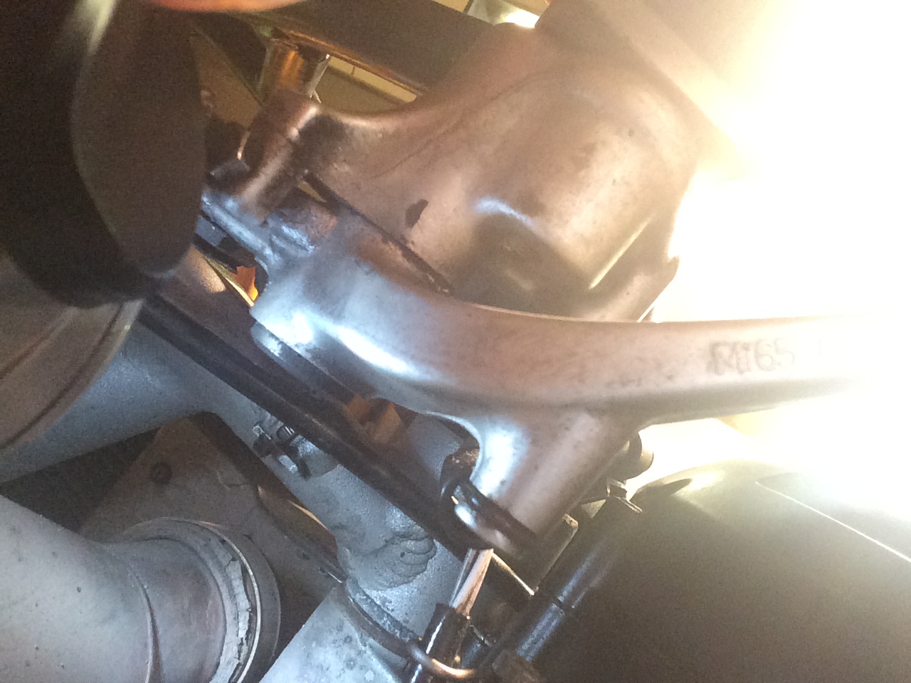

See photos of my swinging arm around the pivot point on the shock mounting side, the images are top and bottom.
Appear to be convex, although the lower weld is not so reassuring.
It would be good if other forum users could photograph there's, we might save a perilous incident.
Cheers Steve

Painter, can you attach a better picture?
Now we have reports of a total 8 bikes with a broken swingarm (4 in Italy, 3 in Germany, 1 in Netherlands).
We think it's about 1% of all Granpasso, Scrambler and Sport.

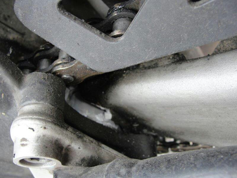

This is another broken swingarm from a member of our forum.
