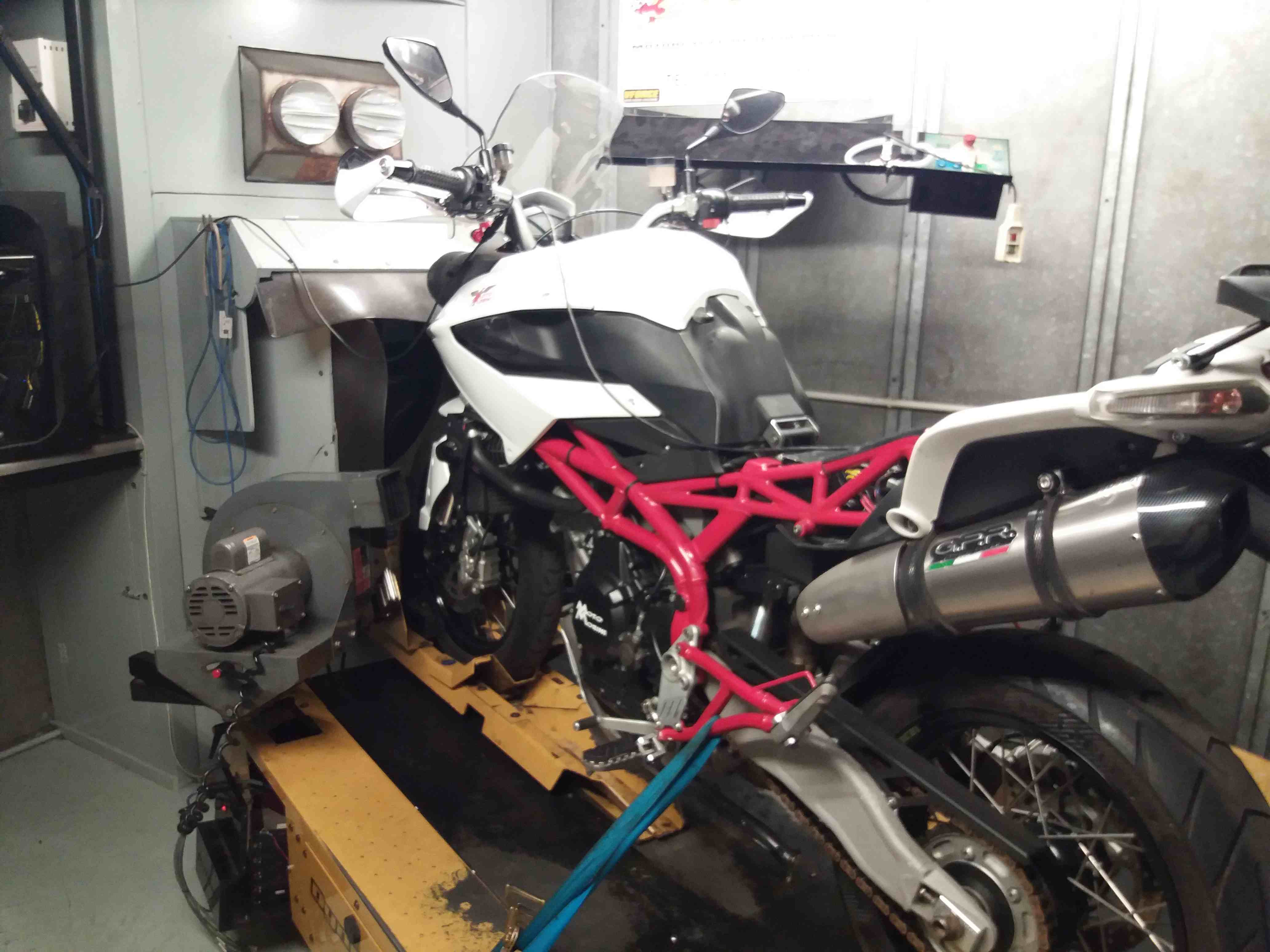

So off to BSD I went last Friday.
Friendly bunch. Loads of tea, very welcome after a 6 oclock start from home in mist and fog!
Step 1. Download the standard map.
Step 2. Remove the lambda probe (not easy, previous owner had been at it!) and throw it in the bin. BSD do a plug to blank off the resultant hole.
Step 3. Install BSD lambda probe to measure the mixture on the dyno.
Step 4. Take a run with the standard mapping. Oh dear. VERY weak, for emissions purposes no doubt.
Step 5. Adjust the mapping. This took about 40 mins of trial and error until Mark (extremely knowledgeable guy on ALL types of bikes, manufacturers etc) was happy to test ride.
Step 6. Test ride.
Step 7. Back in the cell for a tweak.
Step 8. My turn to road test.
Step 9. Another tweak. Due to different riding styles required to stop intermittent close throttle stalling.
Step 10. Another road test.
Step 11. Another tweak to smooth the just off idle performance.
Step 12. Another road test.
Step 13. There isn't one. Bike runs perfect.
The result, just over 116bhp at the back wheel and over 70 footpounds of torque from just under 4000rpm.
These are just figures. On the road the bike is transformed. From around 3500rpm a wisp of throttle will see you heading for the horizon at speed. It will pull happily down to 2000rpm in top and pull cleanly, obviously taking care with the throttle as you wouldn't normally ride like that! The engine is smoother. Pull off is normal. Once I stop playing with my new found performance I'll check the fuel consumption. Before it was around 40mpg, mainly because I used to have to keep to at least 4000rpm as the low speed running was diabolical.
