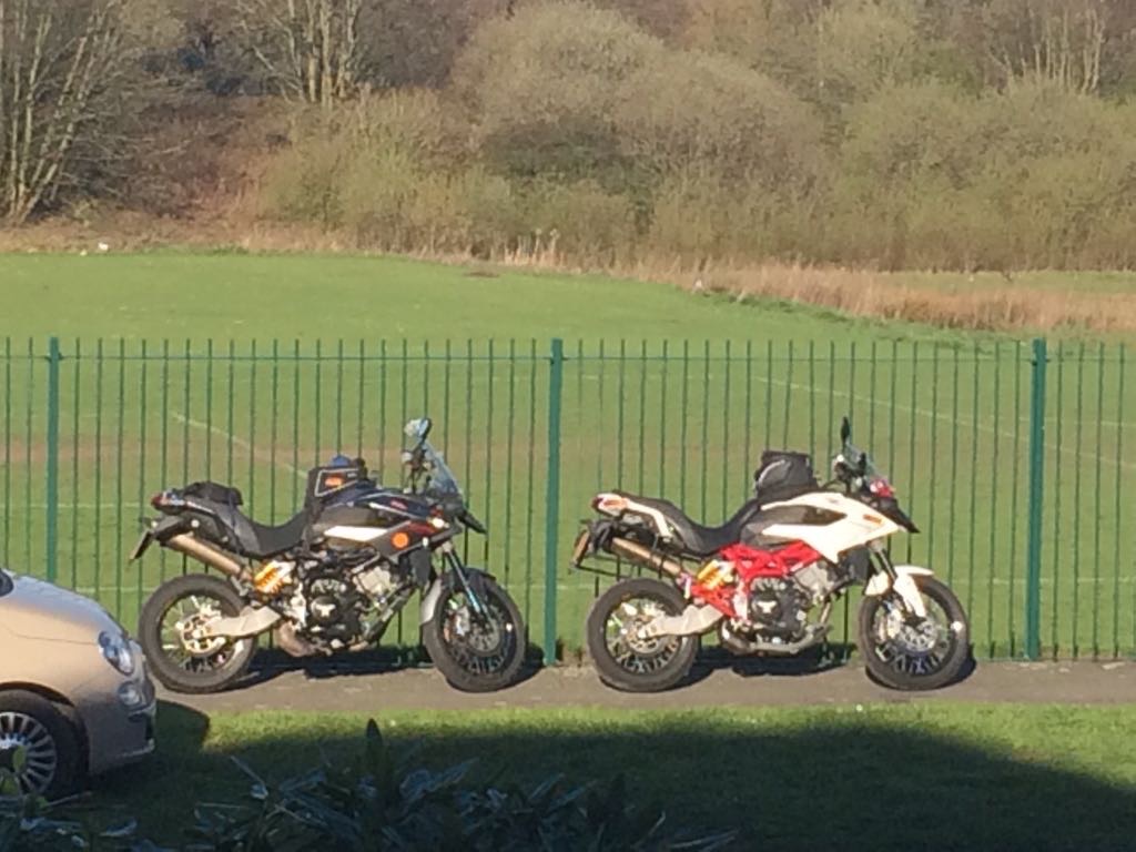

Hi
Interesting to see you have clocked up serious mileage without any problems other than the usual which I have also experienced. You mentioned a cat delete, have you bought a link pipe or is that just the chip, I have been looking to remove the lump for some time and have even gone as far as a custom fab system, any thoughts from other owners.
The WP forks sounds like a great mod, are they the same OD as the morini are you using the same 2pot brakes etc.
Very interested to do this as it is very harsh over bumps as stock.
Still love this bike and it never ceases to put a grin on my face every time I ride, not many bikes I have owned have done that. WIll need tyres chain and sprockets soon so will be keeping it for many more years to come.
I hope to be out and about this year on the GP so if anyone fancies meeting up
Best wishes steve
Best wishes steve
