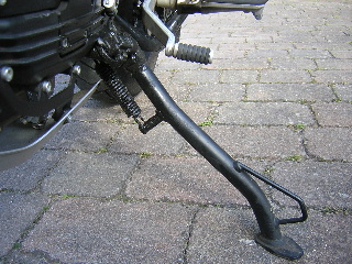

Could anyone post up a Very close picture of their sidestand for me ( from the front preferrably)...perhaps someone could also measure the gap between the extended sidestand and the ground when the the bike is at 90 degrees upright, as mine seem to almost lay down before the pad touches the ground...

A couple of pics I hope will help. A bit grubby but that's the chain oiler for you.......The gap between plate and ground when the bike is upright is about 3 cms.

Thanks for the pics..my side stand looks no more bent than in the photo so I presume its just wear in the bush and bracket and the broken spring as no way is there only 3cm from my plate to the ground :shock: I have checked and there is no sign of any cracks or welding failure so unless the bike has been taking growth hormone I can only think its wear and tear :lol:

Quick update..turned out that teh broken spring and worn bush had made the stand bend..when compared to a new bike the bend was obvious..3x changed the stand and replaced the spring under warranty..I shall be careful where I park it especially when its loaded..
