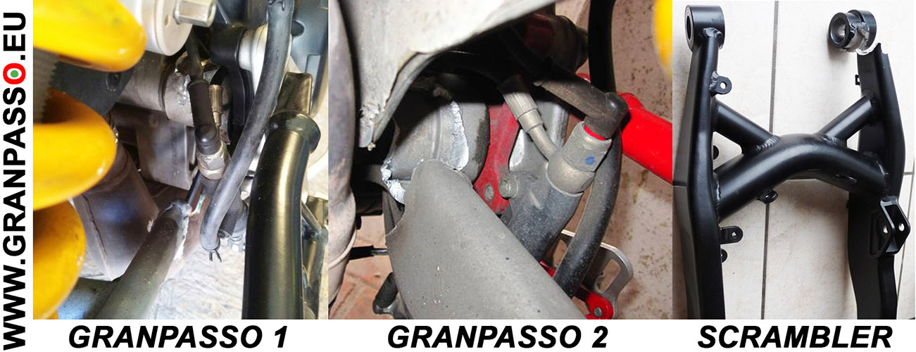

Hello, I'm Maurizio from the italian GRANPASSO.EU forum.
In important that you check your swingarm (Granpasso, Scrambler, 1200 Sport) and look for fractures, because it could break near the ohlins shock.
The university of Stuttgart, Germany, found that the broken part is poorly developed and manufactured.
Here you can follow the discussion.
http://www.granpasso.eu/forum/viewtopic.php?f=4&t=3057
Re: Bronken Swingarm
Posted: 02 Jan 2016 17:56
by Maurizio_Granpasso
One of our best Morini mechanic in Italy told us that he don't believe that the problem was a poor develop (as written in the university report), but instead he stress that the problem was a bad welding.
If you look at your welding at it has a concave form, you may experience the fracture of the swingarm.
A concave welding means that the two part of the swingarm were too far during the welding process.
The welding must be convex.
Check also for fracture of the welding.

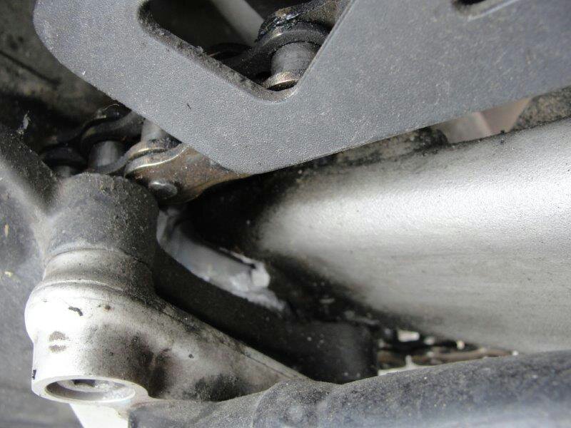

Hi
Thanks for this important update,
This is potentially a time bomb for some of us not easily forgotten at 90 mph.
See photos of my swinging arm around the pivot point on the shock mounting side, the images are top and bottom.
Appear to be convex, although the lower weld is not so reassuring.
It would be good if other forum users could photograph there's, we might save a perilous incident.
Cheers Steve

Now we have reports of a total 8 bikes with a broken swingarm (4 in Italy, 3 in Germany, 1 in Netherlands).
We think it's about 1% of all Granpasso, Scrambler and Sport.
This is another broken swingarm from a member of our forum.

Posted: 05 Jan 2016 10:17
by Painter
Hi Maurizio
Please see attached pic of my 09 GP swinging arm, from the shock side.
