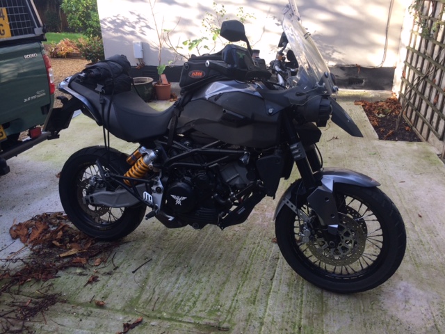

It's been a while so I thought I would give you all an update on my life with a granpasso 2 years into ownership.
I bought it at 6k although I am not sure about the mileage, it now has 11500 and about to get a full going over now that it's
Very cold outside, it's my all year round do it all bike.

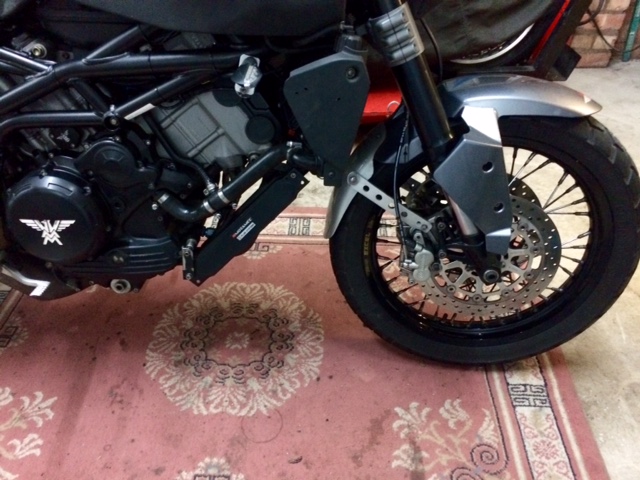

I have made a few modifications to the bike, see pix changed the coolant for a non water based high temp stuff and fitted a big oil cooler which does help a bit , as the bike gets upto temp at the first hint of stopping 98 c and the fans come on , now it takes a little longer and I am not so paranoid.

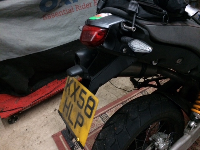

The indicators front and back have been junked and I have fitted some simple led rubber mounted ones on some brackets and covers ,I made up, functional I believe it's called.
Also the front fender extender, which keeps the crap off the oil cooler and exhaust.

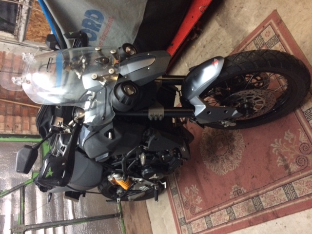

The front screen is from a BMW GSA which I once owned and loved but heavy and not quite so good on the road as the GP.
Gives great weather protection and since I ride with a Davida open face I can sit all day at 90.
Hid lamps on both dip and main works brilliantly.

Pix of my Granpasso
- image4.JPG (139.69 KiB) Viewed 13576 times
- image2.JPG (119.71 KiB) Viewed 13576 times

Blimey, just looked at your number plate, and my heart skipped a beat for a minute as i thought mine had been cloned.
Number plate on my ex Torque bike is KX58 HLO They must have been registered on the same day after each other!
I saw your comment on the other thread of living by me, I would not mind having a look as I have not seen a GP in the flesh!
