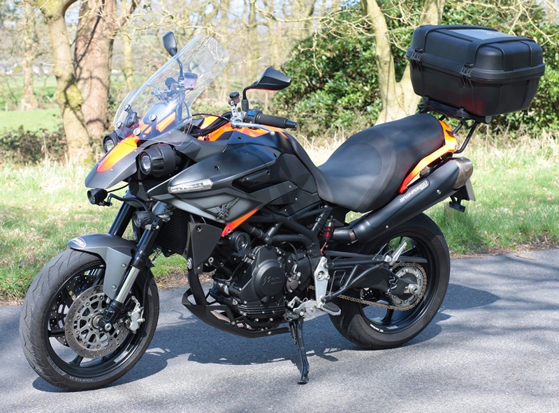

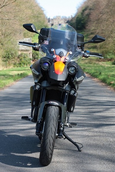

Post by ogr1 »
lstrbrr wrote: 20 Apr 2021 15:10 Hi everyone
Has anyone fitted auxiliary lights to their GP? I have a 2009 model and am considering beefing up the lighting but am not sure about where would be best to mount lights and whether there are any suppliers/models you can recommend.
Hi.
Have a look here https://www.bikevis.com/product/bikevis ... ng-lights/
Mounting them is a headache, or was.
Light bracket from https://www.ebay.co.uk/itm/184954412368 ... %3A2332490
Fitted this under the front beak and the lights now turn with the handlebars.
Also swapped all plugs with superseal ones as the light plugs were not compatible with the loom auxiliary plugs.
Easy to do.

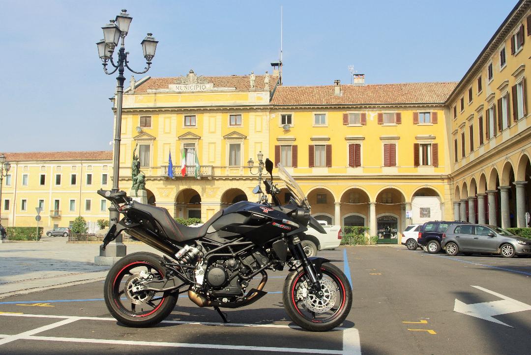

Post by corsaro chris »
The bike pictured is a version of the GPR (GranpassoR) - probably a really rare version of the standard Gp, but with 17" wheels. Great to ride, I tried one at the Factory back in 2017 (so long ago now...)
