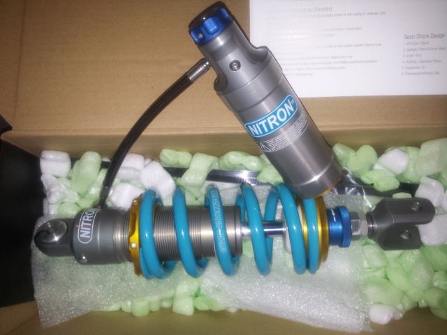

My bikes booked in Tuesday 11th to have my Nitron Road and Track Shock Fitted see pic. The CAT will be removed too. Forks will have their Oil changed all by a local custom bike builder called Attitude customs. Si, the owner is mates with my brother, didnt know that at the time of going in. An amazing work shop like a mini OCC. quoted me £130.

- Detailsonshock.jpg (173.63 KiB) Viewed 28339 times
- nitron track and road shock.jpg (208.77 KiB) Viewed 28339 times

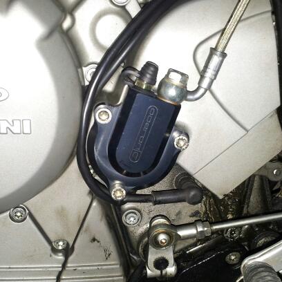

7,Oberon Precision Clutch slave cylinder. easier for me to pull in the clutch, smoother operation too.

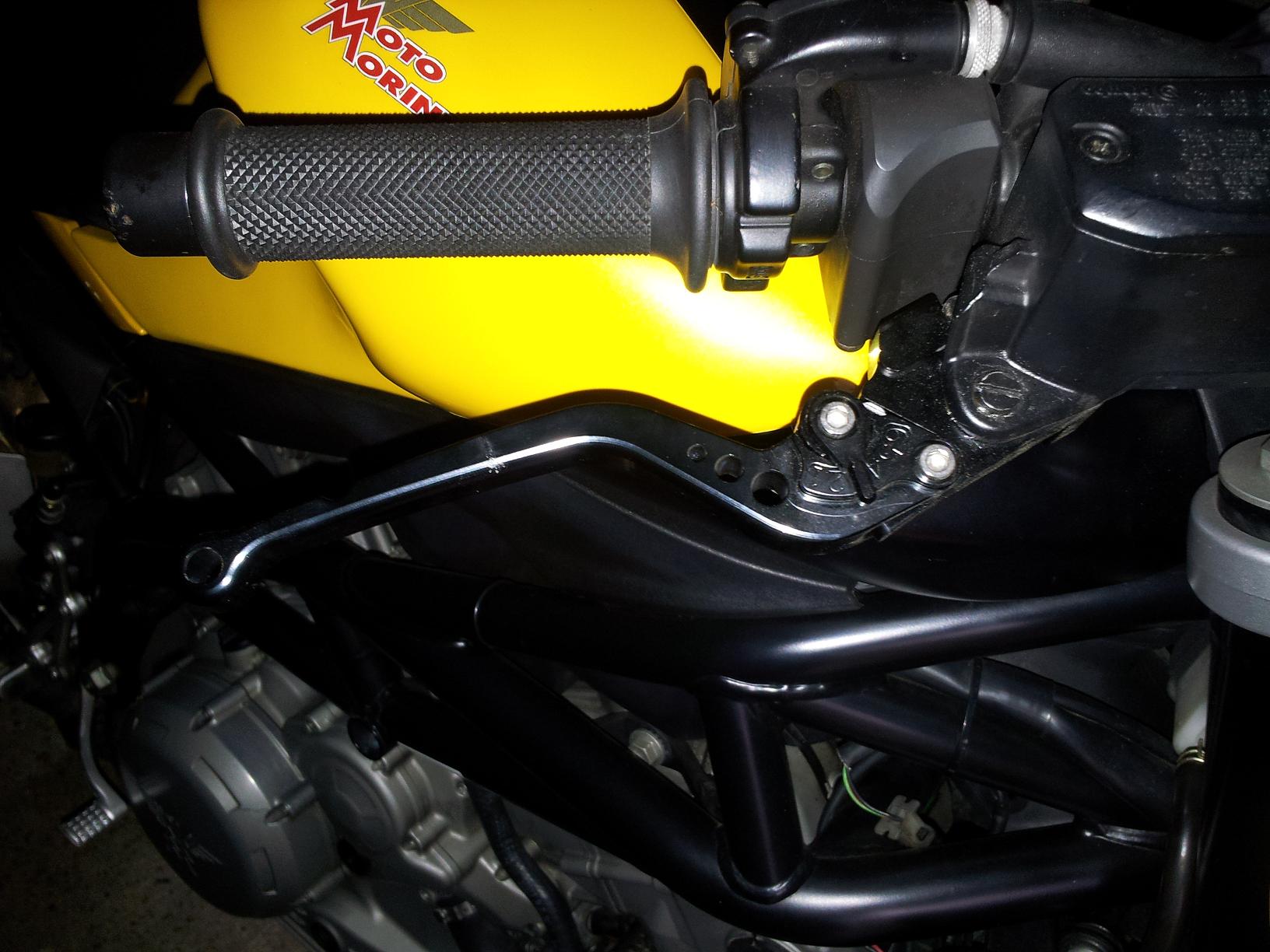

Levers are shorter ones by by V-Trec (in black) a German company see Picture. and I went for Michelin Pilot 3 tyres front and rear. I found and fixed a faulty electrical connection under the passanger seat see Picture. As I was finding it hard to use the clutch on my left arm/hand, I contacted Oberon Performance, who happen to be 30 minutes drive from me too. I fitted one of threir performance Clutch Slave cylinders see Picture. The result is a smoother clutch operation combined with a better feeling lever too. (well worth it).

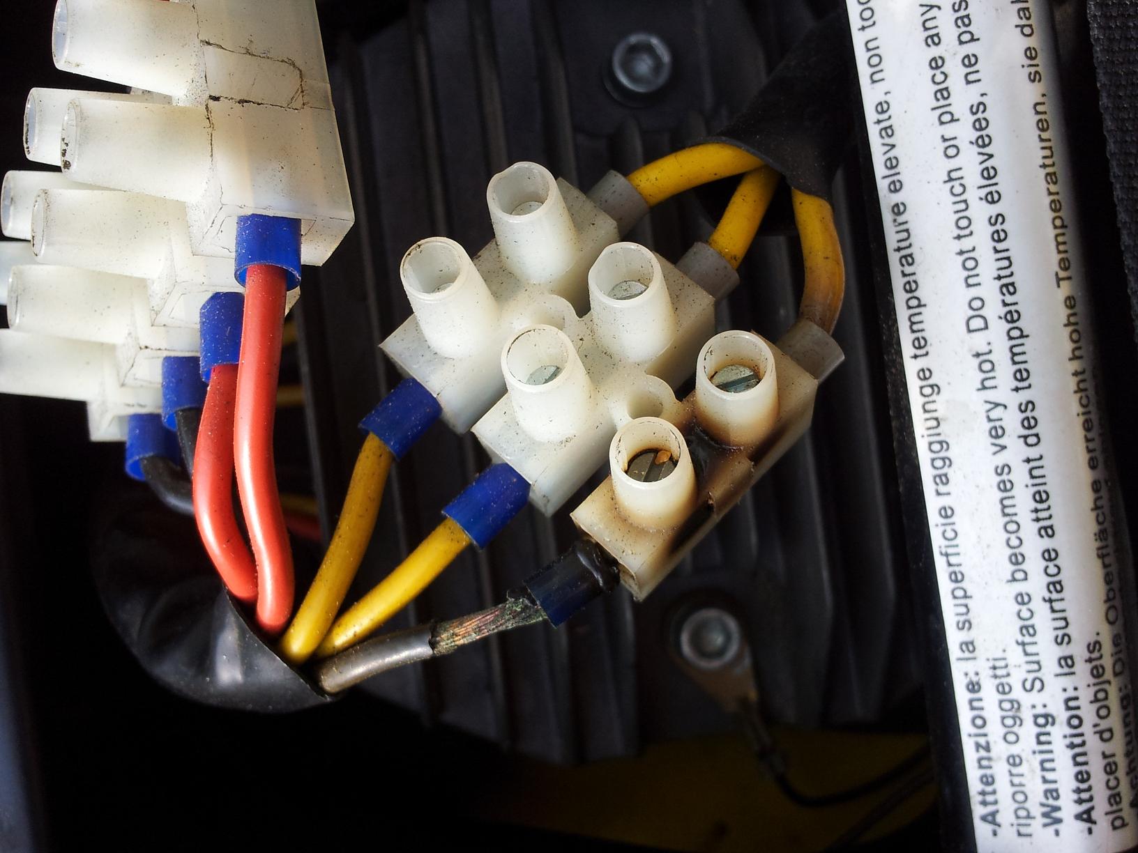

Faulty electrical connection under the rear passanger seat, Its now repaired.
