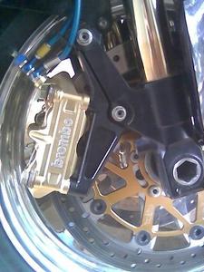

the fork upgrade kit is about £400 on ebay.co.uk with all adjustments at the top of the fork and none at the fork legs , which seems to be a better way as a lot of the manufacturers seem to be doing this.
on ebay.it you can get new radial calipers to suit a benelli tnt/trek which use the same calipers as the morini. These come with a cnc adapter plate to suit the existing fork bottoms , so no new fork bottoms are required. These come with new radial calipers. Price £500 upwards.
If you want the hassle of adapting the wheel spindle and making up different spacers some of the mv forks are a straight swap with stanchions at 50mm,with top and bottom yoke sizes the same. If you have access to a lathe to make or adapt a wheel spindle then that's an option.
Re: Corsaro veloce 'R'
Twisty: You are right, the adapter for calipers is available. Unfortunately it is ugly as f**k. On the other side, it will be working well...

thanks a lot twisty that's a big help! I am going to have a look on ebay now and see what I can find, so the fork bottoms that suit the mono-block calipers come off a benelli tnt? this way seems a lot cheaper and I will still get the look I want, thanks for the picture franco

I have copy & pasted the item number and found it on the English ebay, so I need to be 100% positive about these so will these fit straight away or do I need the adaptor plate? thanks twisty realy appreciate it
Ryan.
The link i gave includes the adapter plate

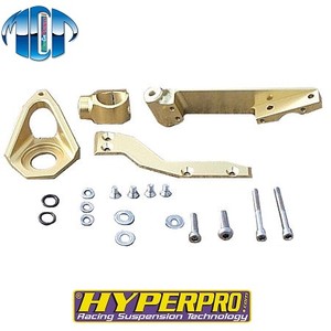

There is also a steering damper mounting available
http://www.ebay.co.uk/itm/MOTO-MORINI-9 ... 4171c35931
