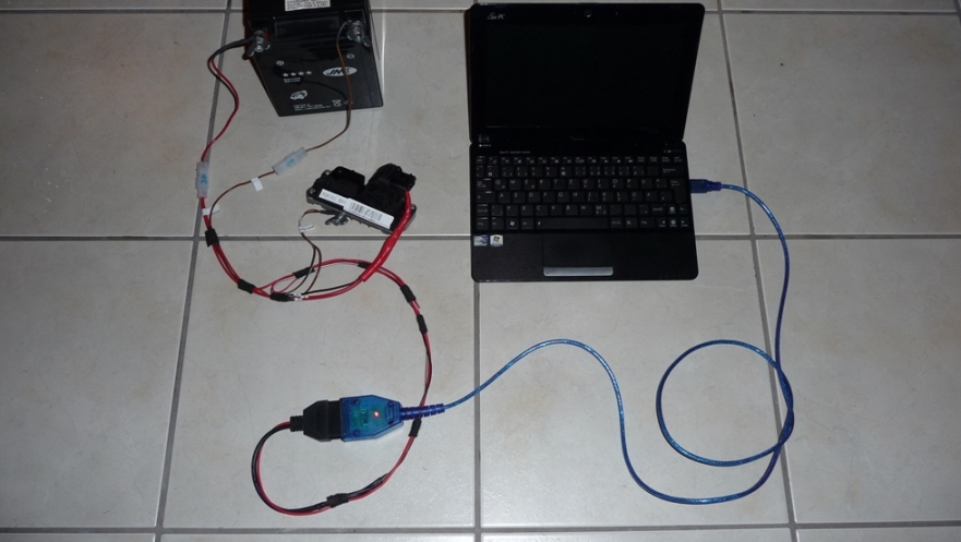

So here is my first question.
Is it possible to do this on the bench with the ECU powered by a 12 supply or does it need to to be installed into the bike?
I suspect doing it on the bench is OK as I cant see manufacturers loading blank ECU's into vehicles and then loading them on the production, maybe wrong.
I will be doing the load soon, but can I save the contents onto my PC of the so called Race ECU?
Hope these questions are not too inane, Thanks.
Hi Chips,
If you want to build your own off-bike connector then you can find the instructions here: http://www.sendspace.com/file/orvozb
just download the PDF. The instructions are from the old Ducatidiag forum but the physical connection is the same for all software.
Nevertheless, it is easier doing it on the bike an if you are new to this I'd strongly recommend getting used to the procedure of hooking things up and working with the software before tinkering with off-bike connectors. To be honest, I haven't done it myself as I was keeping it for the dark winter days and my second ECU and like Gunni says, the pins are quite delicate.
About ECU types: there's no hardware difference between the so called Race ECU and the standard one. Both are regulare IAW5 units and the only difference is the map that is flashed onto it. In my bike I didn't bother swapping ECU and it is a bit delicate too with these connectors and lots of small pins. I simply wrote a new map and that's it. My second ECU I'm keeping as and insurance policy ... just in case.
Regarding the serial chips: these are integrated circuits that convert an old-style serial bus to USB which allows connecting the cable to your PC. There's nothing fancy about it, just that it is a part used by the cable manufacturers to achieve that goal. Problem is that they don't all work as good and that there are counterfeit items on the market. Your PC needs software drivers for these chips aka IC and normally windows recognizes them and installs them automatically. However some of the manufacturer's latest drivers contain extra security that on purpose disallows the proper functioning with counterfeit items. And you've guessed it, usually from Chinese origins. Not that all that comes from China is bad. I guess that almost all cables come from China anyway but something to look our for. Anyhow, you should have discovered what chip it has by now. How to discover in windows: control panel -> device manager -> you should be able to see a virtual COM port when the cable is inserted (COM & LPT) -> select it -> right-click and select properties -> TAB driver shows manufacturer. Between parenthesis it should show the COM port number in use. That's the one that Guzzidiag needs to be configured with (but it seems to detect that port "automagically" too). These instructions are just in case that it doesn't work out-of-the box. :mrgreen:
When you connect up the cables make sure to connect the red 12V crocodile clamp as shown here:
Connecting it to the battery connector under the buddy may harm the ECU due to voltage spike when starting the engine. Better to be safe than sorry.

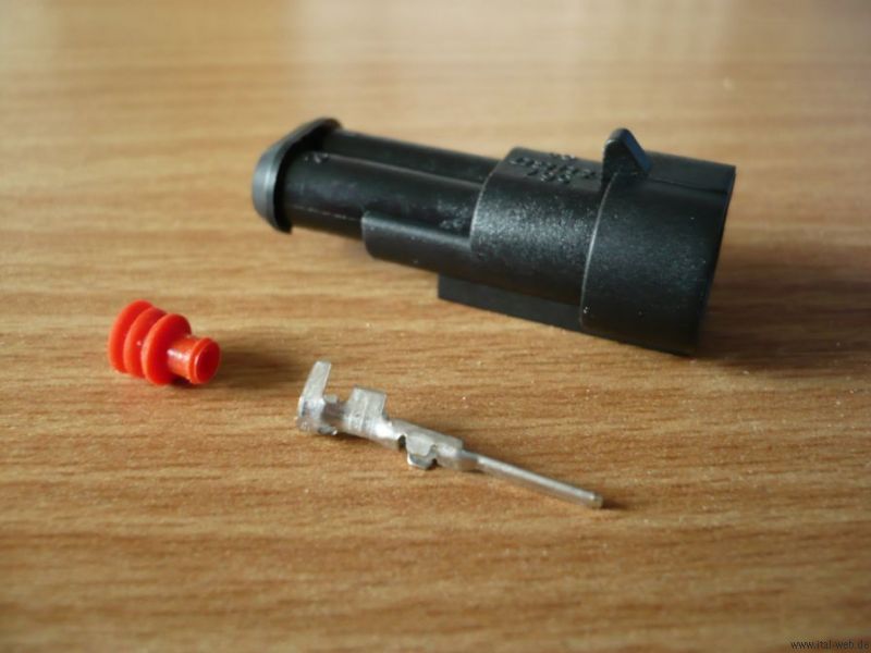

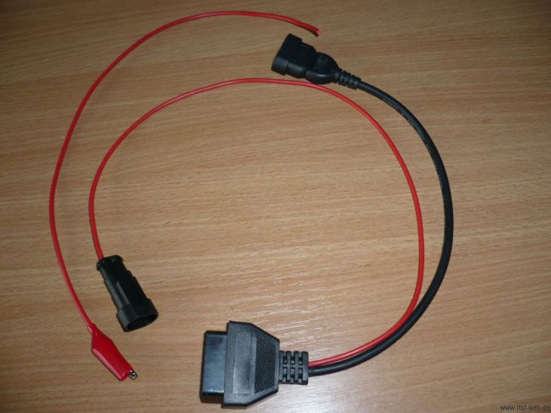

i choose a smarter way :wink:
amp-connector with pin
the pimped fiat-adapter-cable for the 12V-connector under the rear-seat of the corsaro

I made a small adapter cable for that instead, also using AMP. I use it when reading or writing the ECU to be sure of a reliable mechanical connection.
The crocodile clamps are firmly connecting to the eyes at the end of the wires. I made them different lengths so that they can't touch inadvertently.
I considered doing what you did but in the end I didn't want to remove the crocodile clamp and preferred keeping the possibility doing it the ARMPAS way when I plan to fire up the engine. :wink:

This threads caption isGreat News. Well thanks to Guy and Gunni I can say so as well.
I installed the "race ECU", which also had written on it "Termignoni", into the bike and started her up. (My bike is fitted with them.)
Difficult to keep going and a dreadful smell of unburnt fuel together with black spray all over my garage door.
So having run through the procedure a couple of times it was time to give it a go.I had to extend the positive cable on the adaptor to reach the connector under the front of the tank.
A blue light glows when power is supplied to the USB converter.
Once everything was connected I ran the Guzzidiag programme in ernest and all was self explanatory. The file EBi uploaded after the ECU was cleared and Bob's your uncle. I switched the ignition off, disconnected the cables and fired the old girl up.
Nay Bother, smooth as you like, what a difference.
Many thanks for this, everybody involved. I will test ride the bike ASAP and report back, definitely the fuel is being burnt now, so it's not over fuelled.
