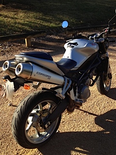

Hi all
This subject has been covered many times on this forum but here goes…….
Relatively Aussie new owner of a 2008 Corsaro Avio. It’s unmodified and has the standard mufflers that the Avio came with as per the attached photo.
It’d been unridden for 2 years prior to me buying it. It’s now up and running with parts ordered via NLM.
The valve clearances are up to date, the spark plugs are fresh and the air filter is in excellent condition.
I have confirmed with the mechanic that serviced it from new that the ECU has never been updated. Morini is unsupported in Australia.
It’s a bit a touchy/rough at low revs but that’s OK, it’s a short stroke V twin which is ridden for fun so it’s not a commuter and it’s still a lot smoother than my Buell. It starts well, idles fine but has one annoying and embarrassing habit of stalling just as I come to a stop unless I give it a quick rev with the clutch in just before I stop.
I’ve been using 98 octane fuel and if ever stops raining here on the weekends I’m going to try a tank of 95 octane (non-ethanol) fuel to see if that has any affect on the stalling when coming to a stop.
There’s a lot of information on this site about remapping with the termignomi pipes with and without DB killers, Veloce versions etc .
I’d like to know if there are any maps suited for the standard Avio configuration with the mufflers as per the picture from Avio equivalent(?) models later than 2008 that would resolve the stalling issue and perhaps help smooth out the power delivery. If so, which maps are they? I’d prefer to install a whole new map as opposed to trying to alter an existing one.
If there are some suitable maps for me to consider then having never remapped an ECU I’ll purchase the required cable and start researching guzzidiag and work up to backing up my current map and installing an updated map.

Re: 2008 Avio stalls when coming to a stop
Check the switch on the clutch leaver I know it is part of the starter system but
on some bikes and I don't know if Morini is one it also acts as a anti stall device
waking the engine up from the over run and in some cases retarding the ignition
so see if it is connected and working, worth a check.
Stalling at low speeds/when using clutch was a common problem with the older maps. Do yourself a favor, invest a little money in the cable and update your mapping.
Thanks for the comprehensive list and the speed of the reply.
Good to know it was a common problem. Seems from the list there's only one map for the Avio, being the later 2009 ECU version. This map is supposed to cure the stalling issues. Hopeful that it might also do something about the flat spot at about 3,500rpm.
I accessed the Google drive link under the Corsaro Runs Rich thread and there's two Bin files for the Avio:
- 23CAMORCAVG
- 23ACMORCAVG Lambada Off
Arrgh….. a bit more research and a few hours of trying and Guzzidiag and Mac computers aren't a good match!
If I can't organise a windows laptop I think I'll end up going to the local Guzzi mechanic and see if he will save my current map and upload the 23CAMORCAVG with the Lambada ON using Guzzidiag.
So I have all the information when I do this can I confirm that:
(1) ECU is IAW5x, same type as a Griso 8V?
(2) TPS reset required? If so what should it be reset to?
(3) CO setting? - Is there any need to anything if I choose the map with the Lambada sensor ON?
(4) Anything else I should know
Thanks again……...
Mac? I had Virtualbox on my Macbook Air and ran XP on that. Worked fine....
2 - under actors you can choose TPS reset. I only know Corsaro, there it resets to 2.7 degrees.
3 - Without CO meter it is trial & error
Start with default '0', do test run. Go +/- 10, depending on test run, do test run etc.......
(when you do more than 220km on a 16 liter tank refill, the engine is running well and the pipes are not black, you are doing OK)
4 - you can use any of the 120hp maps
I would start with a tested scrambler/granpasso map, as those are the most popular models.
(if there is such a thing amongst morini's
1 - yes, any 8v will doSo I have all the information when I do this can I confirm that:
Thanks!
I will look into the Granpasso and other 120hp forums for some thoughts on the best of the 120hp maps available on the Google Drive address which will alleviate the stalling and flat spot at 3000rpm.
I‘ll also investigate virtualising a version of Windows onto my MacBook Pro so I can use Guzzi.diag. If virtualising Windows proves to be beyond me I think I will borrow a Windows laptop once I have the cable. I like the idea of being able to try and compare the maps myself.
Update
Cheap Windows laptop and Lonelec GuzziDiag compatible cable purchased.
GuzziDiag tools downloaded.
Wildguzzi step by step instructions with GuzziDiag screen shots studied.
Backed up existing map (15 mins)
Uploaded 23CAMORCAVG map and reset TPS (7 mins)
Result - A much better bike and well worth the effort. Stalling issue has completely disappeared. It seems to run a bit smoother at lower revs and the flat spot has noticeably decreased so much so that I'm still not sure that it's still there. Fan comes on at 96 degrees instead of the previous 90 degrees.
I went for the 23CAMORCAVG with the Lambada sensor as a days ride can either be down to sea level or up into the mountains. My other bike, a Buell has a map with the Lambada off and it doesn't run too well up in the mountains. Because it's so easy I may try some of the other 120hp maps later but at the moment I'm satisfied with the new map.
I also replaced the chain at the same time.
Here's hoping there's happy days ahead.
Thanks to all from the forum who provided advice and 'danger1474' who I pm'd a few times.
Without this forum and the willingness of its members to assistance in this thread and the two others ones I started 'New Owner - Stator connection, speed sensor, Oil filters' and 'New owner & oil leak' there's no way I would have been able to give this bike its second chance in life (I'm its 2nd owner!).
