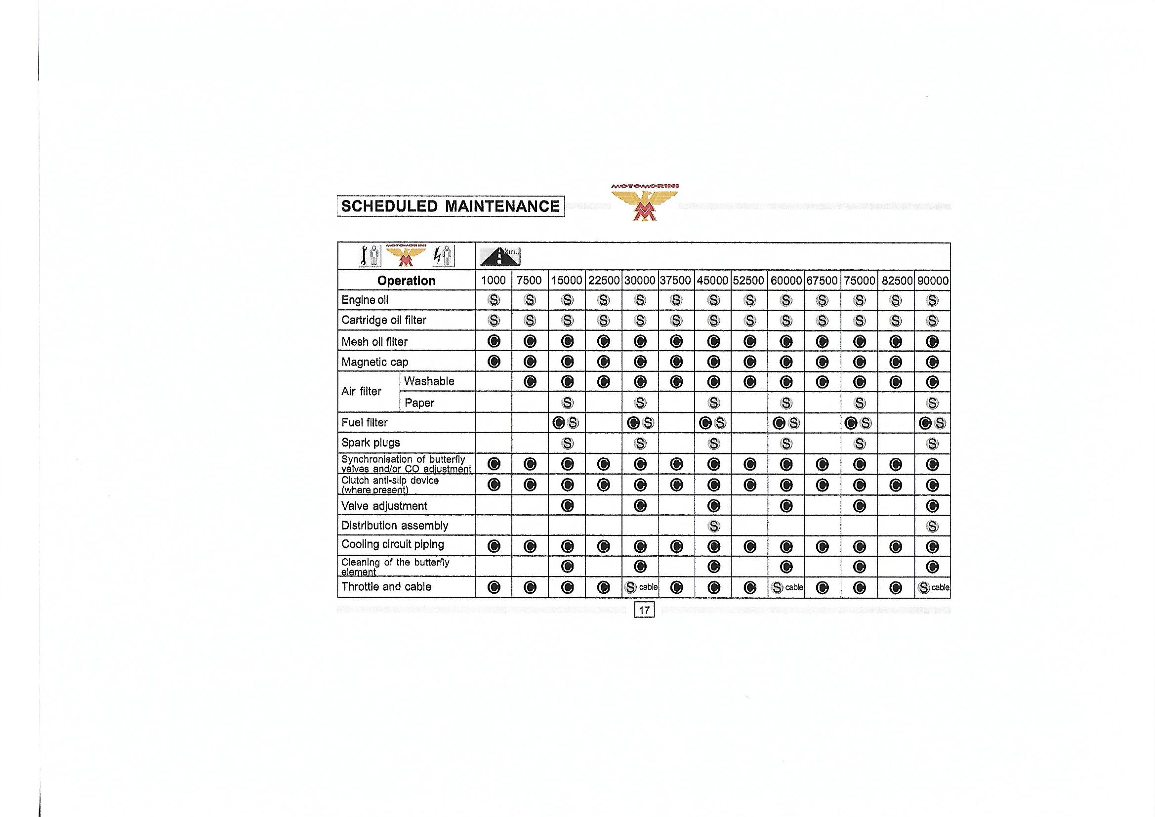

For the post 2013 engines the 'distribution system' (cam chains) are scheduled to be changed at 45,000 km and 90,000 km; that's just over 28,000 miles. There have been several modifications, and the original service manual for machines from 2006 - 2009 scheduled a check of the cam chains at 30,000 km and replacement at 40,000 km.
Attached is the extract from the current service manual booklet, for those who don't have a copy...
Good riding, CC

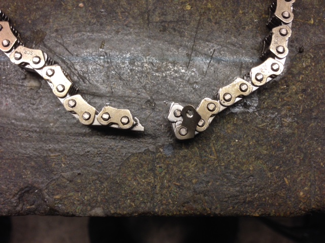

Diagnosis: Cam chain (narrow type) of the rear cylinder broken at 2500 rpm, fortunately nothing else broken, the chain was laying between the two cams, valves were closed.

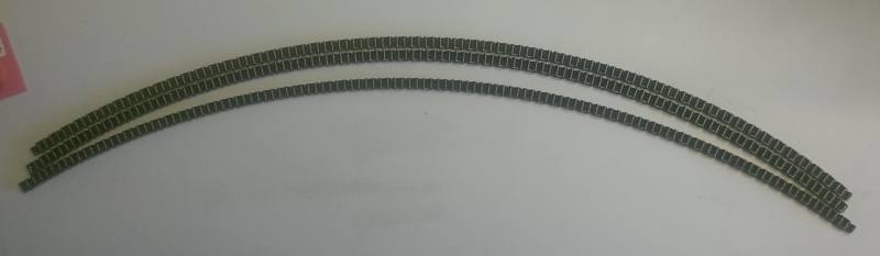

The reason for this posting: It was a new standard DID SCR0412SV cam chain running just 5000 miles ! A closer look at the old 25000 miles chain and the new broken one brought these differences:
New and old cam chains
At the top you see a brand new DID SCR0412SV, below the broken one and at the bottom the old chain. I decided, not to install a new DID chain but to install the old one until further clarification. If pulled, all three chains have the same length, but the new chains can be pushed together 7,4mm and the old one only 5,4mm. I hope, that the modified chain set with the wider chain will be deliverable within the next months by morini. If not, an alternative maybe Borgwarner which was in a later Morini price list and seems to have a higher specified tensile strength.

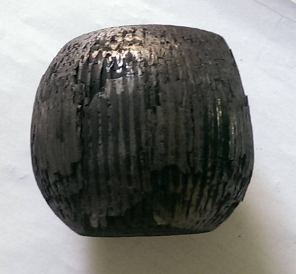

:mrgreen: No, had some serious engine problems last year, piston of rear cyl damaged, didn't know why. Went back to a richer map 23ECMOLCORC (which you should try if you haven't so far) but engine was still not running at full power, then finally found this catalysator:
Now, power is back and in 2017 I'll continue with 08.

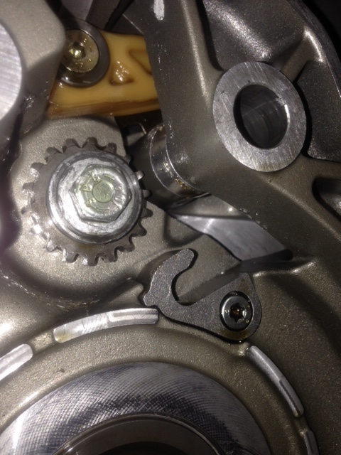

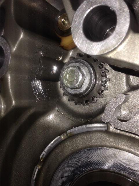

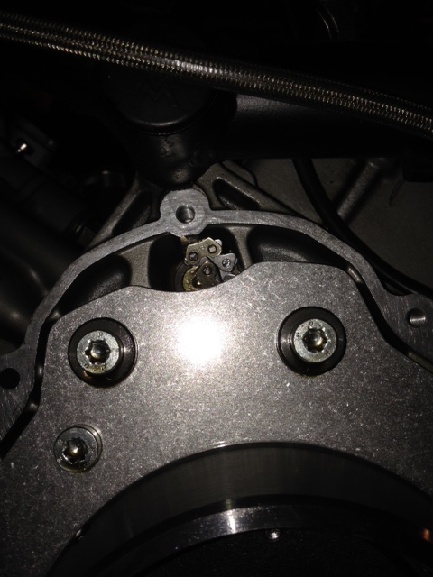

Managed an hour or so in the garage today. All set to have a crack at the flywheel, realised that the largest deep socket I have is 24mm. 3mm too small to get the flywheel nut off. Bugger.
Still, got all the cooling gubbins off and the front cams out. Front head will be off in no time.
Don't like the look of this though...

According to Stuart and Rob at NLM, yes, they are currently on chain number 4. Having changed designs and suppliers. The ones they have on the shelf are very slightly wider than the broken one on my 08 bike. Not much though (and I only measured it with a ruler while it was still in the bag) I don't remember the name of the maker but it isn't DID.

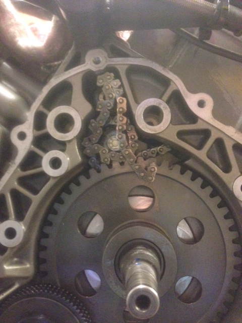

Got the flywheel and starter gubbins off this afternoon...
Looks like I've been a lucky boy. Just a few minor battle scars. Phew.
backfat1187
Posts: 125
Joined: 13 Mar 2011 23:11
Location: Leicestershire UK
Location: Leicester, UK
Re: Poorly Veloce
Post by backfat1187 »
Pesky chain
