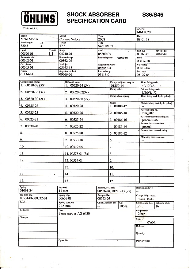

Veloce Ohlins shock specs.
Post by backfat1187 »
Might be useful to someone
