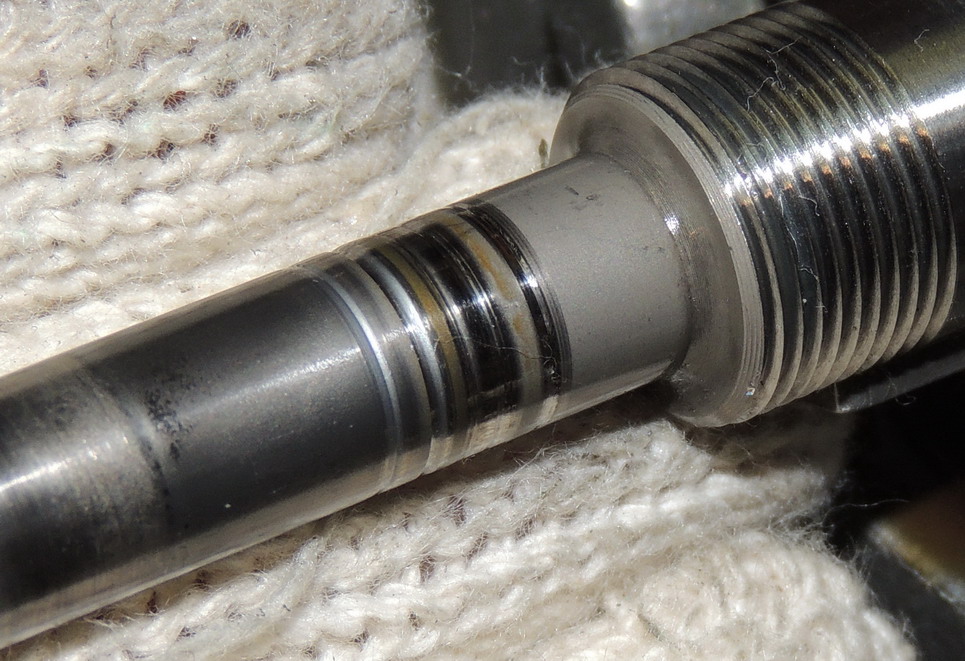

Hi, you need to check shaft place where contact with seal, may be wearing and need or repair or changing shaft with bearing.
had the same sign. antifreeze in oil. ended with the replacement of the water pump shaft.

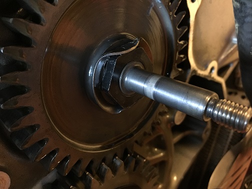

Timing cover off today. The pump shaft looks in reasonable shape to me. You can see the difference in colour where the seal sits on the shaft and can feel the very slightest bit of wear. It's like there's a tiny change in surface texture. Detectable by finger tip, but feels perfectly smooth if you run the end of your fingernail along it. No visible wear as such. Nothing like eddydogs.
Compression test was inconclusive due to the de-compressors. I did get around 60 psi consistently from both pots though, which is mildy encouraging.
I popped in to see the good gentleman at NLM today. Chris was inclined to think that it was unlikely to be a head gasket. Also mildly encouraging. He also advised doing a leakdown test. I'll do that next.
It's impossible to determine the state of the shaft seal really. I'll just replace it. This time though I'll make a seal bullet out of brass to make absolutely sure there's no damage to the seal on installation.

My thoughts about the wear of the shaft. There is such an axiom. What was the first? Chicken or egg? In my case, it started with the appearance of antifreeze in oil. First a little. Continued to ride. Then more. The shaft has two plain bearings. Or at first there was a wear of the bearings, and the tip of the shaft with the rotor blades had a beating, because the wear on the shaft was from the rubber seal. Or, at first, the stuffing box began to skip, and because of this, the bearings began to wear out and the shaft beat (deviations) was increased. It is good that the shaft has no signs of wear. But you need to check for moving of the shaft tip, beating upwards, from left to right the tip of the shaft with the rotor blades. May be bearings has some gap. But these are my not professional thoughts.

So I've tried to measure the shaft deviation. Not easy to mount the dial gauge in a totally solid place. Just cranking the motor over by hand affects the reading.
However, the value is around 0.08mm at the shoulder nearest the small thread, and around 0.04mm where the seal lip sits on the shaft. That sounds a lot to me (based on precisely zero experience in these matters) so I'm really hoping someone can tell me otherwise. No apparent play in the shaft bearing and it feels perfectly smooth when turning the engine over.
Failed to do a leakdown test due to lack of 10mm hose adaptor. Grrr.
Spring seems to be approaching much more quickly now the bike's in pieces....
