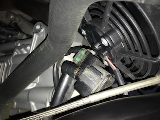

Yes, what Mickey says.
The fuses by the starter relay are a weak point. The modification was to drill a small hole in the corner of the fuse holder cover to allow water to drain out, and a liberal application of electrical grease.
The starter relay and these pesky fuses are on the left hand side, behind the radiator.
The workshop manual is indeed in the members area, if you are a paid up club member (well worth it)
Finally, make sure the bike doesn’t think it’s in gear (even if you know it’s in neutral- check what it says on the dash) and try with the side stand up & clutch pulled in- as these safety interlocks can prevent it from allowing a crank.
If you need to jump start it from a car, rather than trying to get onto the battery (a pain as you have to remove the seat and it’s hard to safely get on a battery terminal) I use the Positive terminal at the starter relay and a good earth point on the engine or frame.
Let us know how you get on.

So I decided to change a few things.
I replaced both the fuses as suggested, then went on and replaced the air filter and both spark plugs. Turns out the spark plug under the tank at the back still had the cap on it
Anyway, I replaced both with new and the rest and it seems to run again. Threw some injector cleaner through it before filling up the tank and then took it for a spin. Needs a tune up I reckon but she is alive.
Cheers gents.
