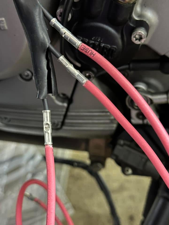

Just to update on this one-
I got some decent butt splice connectors and crimped these into the alternator wires, and run new wires all the way to the regulator, of a decent quality and larger gauge. Double insulated everything with adhesive heat shrink.
Now getting a consistent 14-14.2V on the dash and no sign of hot melty wires.
- IMG_1478.jpeg (85.09 KiB) Viewed 3484 times
