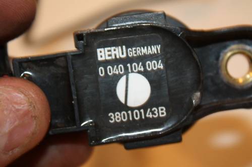

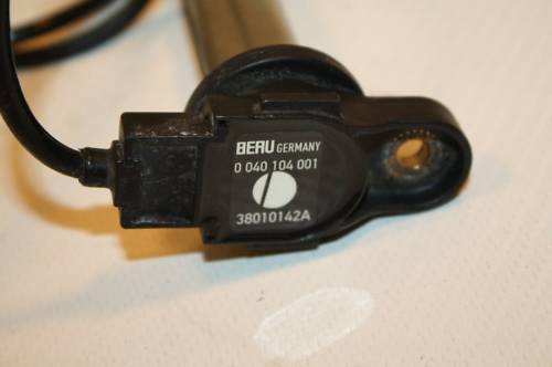

Also ducati 1098 fit directly as they have the fly lead. Same coil as 1198 and 848.
The old ducati 749/999/999s coils fit , but i think they may or may not have an electrical fly lead like the morini.
Some pics online show the 749/999 coil with a lead and others without. Probably related to model years
Only know as my bike was off the road when i first got it waiting for coils for quite a while.
the good thing about the ducati 1098/1198/848 coils is no adapter leads are needed as its a straight swap with long fly leads already fitted just like morini's

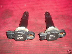

749-999 coil stick
749-999 coil stick

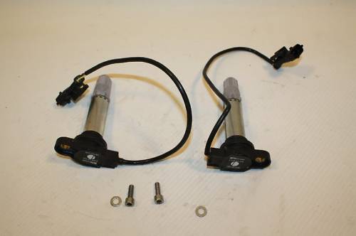

1098-1198-848 cpencil coil
1098 -1198-848 coils

just checked the buel coils.
they have a very thin sleeve that slides off and then they fit in the morini fine. the original seal needs to be taken off the old coil. The sleeve is so thin that its hard to even guess it comes off.
They have a 3 pin supaseal type connector , thus a 3 pin female would be required to make a fly lead.
