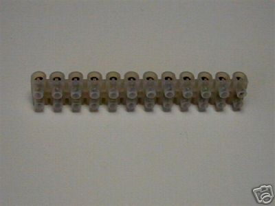

Twisty- Regarding the 'bodge non standard connector' -if you are talking about the 'chocolate block' type connector under the pillion seat- this is supposed to be there believe it or not. I agree that connectors like this have no place on a motor vehicle but this was one of the warranty updates. My bike had it fitted from new so I don't know what the 'unsuitable' connector they removed was like but I imagine it was a small and poorly spec'd AMP Supaseal. If you see evidence of wire damage near this connector then bear in mind it may have occurred before the 'chocolate block' update was done on your bike. Check that all of the terminals are sufficiently tight ( not overtight though...) but leave the choccy block as it is...

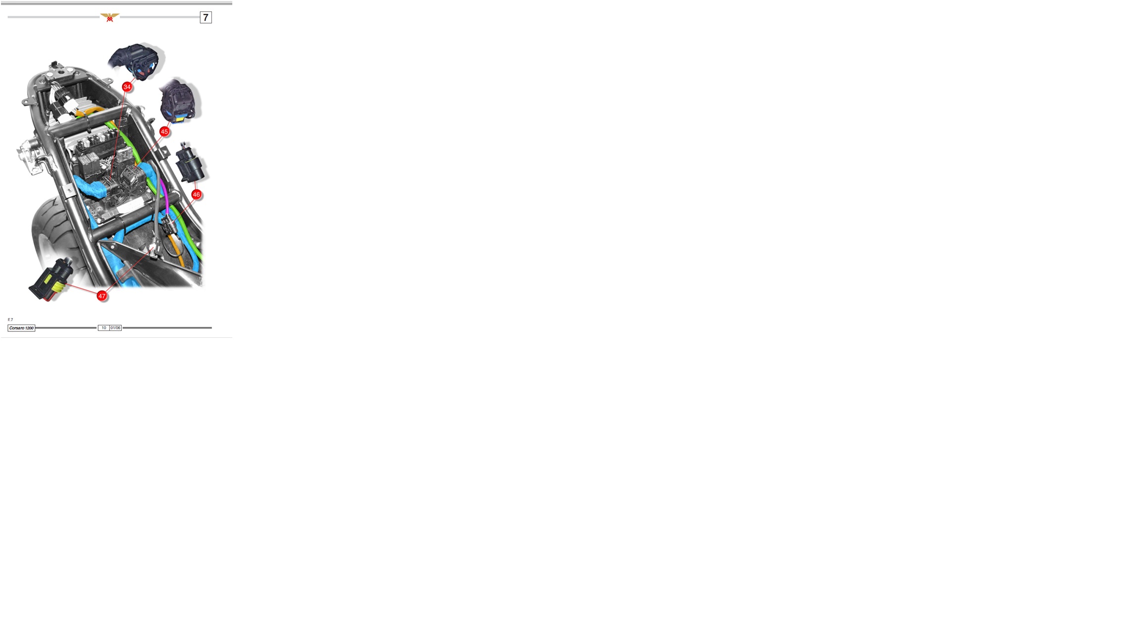

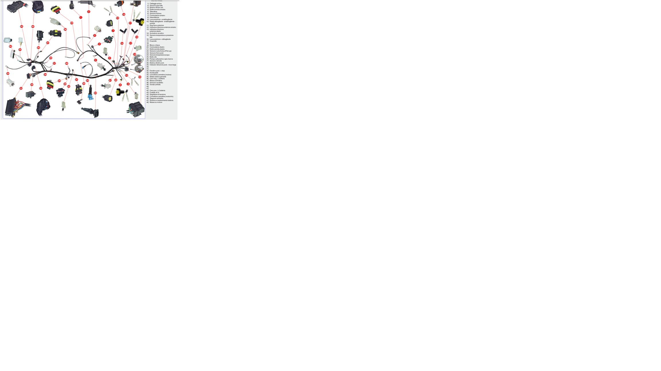

nearest pic i can get is from the manual on page 238 but not enough detail
just realised that what you call a choc block i call something else. WHAT A PILE OF DIY crap :evil: to put on a bike as an upgrade. I thought it had been done as a diy job. Now i know that it was done on purpose i'll think about checking that plug halfway down the frame i was referring to.

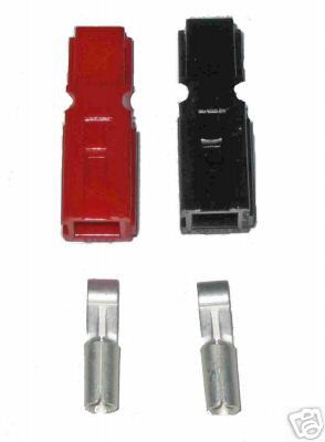

this was the type fitted to the end of the 3 yellow wires on my bike
but i think i'll replace the diy warranty one with these
GENUINE ANDERSON 30 amp POWERPOLE CONNECTORS
GENUINE ANDERSON 30 amp POWERPOLE CONNECTORS<br />GENUINE ANDERSON 30 amp POWERPOLE CONNECTORS
ebay about £6 for a set of five male and female with connectors

i've trawled the manual , i must be blind,or senile , where's the wiring diagram schematic :!:
