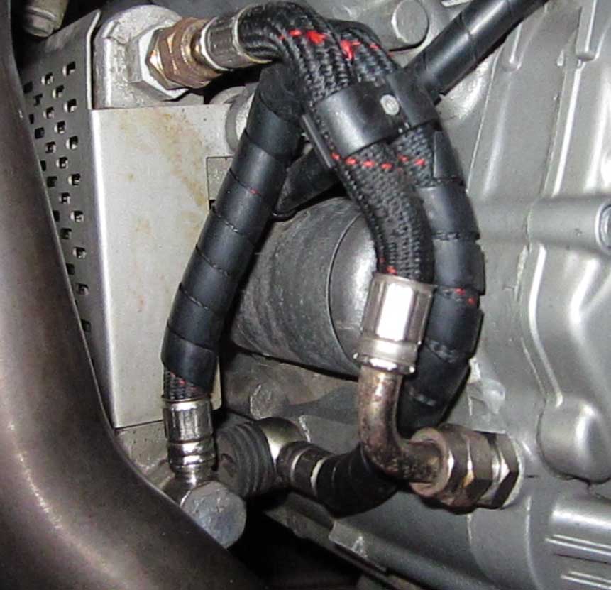

Well I tried as you said except that I didn't use Solvol, as I have not got any. So Tcut and Brasso don't work, but I'll get some this week and give it a shot.
But as I was down near the front pipe I noticed the oil pipes and starter cable were chaffing, so cleaned it all down and removed the clamps, put some spiro wrap on the oil pipes and the cable. Put the clamps back, but will keep a close eye on the situation. Thanks Dave.

Hi George,
I think I mentioned that at Devil's Bridge. If you look on this forum I think you'll find some photos of one where the pipe has split. An obvious design fault that could have serious consequences...
Mike.
Mike.
Re: New Cosaro1200 rider in Cumbria
Hi Mike
You certainly did mention it at devils Bridge and I'm glad I never checked it there, here is a photo of the spiro wrap, not as interesting as K.Knightley but we can't have everything.

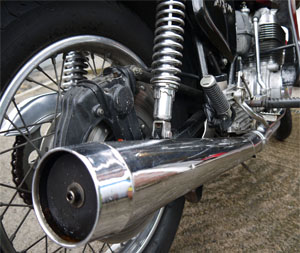

Well still have not managed to get hold of the Camel as yet. Went out and as it's a fine day up here fired up the old CB705 and away she went, decided not sell here, stopped the auction on EBay. Just have to find some room now.
- cb750texhaustsmall.jpg (58.34 KiB) Viewed 22344 times
