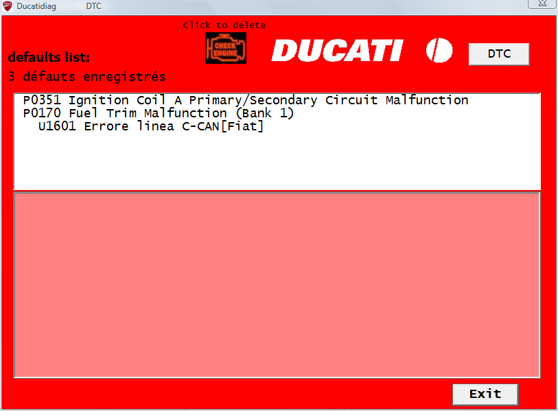

this is the error i'm getting
Ducatidiag DTC_2011-04-15_16-29-10.png (57.82 KiB) Viewed 26593 times
I've swapped the coils to eliminate the fault codes. I'll need to take another reading once the laptop has recharged.

did you get chance to recheck the DTC's -
did swapping the coils move the fault code over to the other cylinder ?

Just run the diags on mine....nothing showing on the on-board display but 13 codes in Ducatidiag !!!
Have cleared 'em all and run it up and mine too is now showing a sole 0351 code....
reckon just about every sensor registered a fault when I had me lock up....
will get ripped into it tmoz....
seems starnge that the 0351 fault is persistent on both our bikes though....wondering if the VDSTS software may have been a better bet after all !!

DaveH wrote:Tom,
not had a chance to check if the error has gone by replacing the coils. I suspect the stepper is just sticking. Has anyone dismantled to lube the piston.
I thought my error codes were bad ,yours read like a dictionary :roll:

Can't see how a sticky stepper could generate a coil fault code....having had a quick look at the tbs this aft, the stepper unit looks sealed...have you managed to strip yours?
As for my dictionary, not too frothed up about it (at the moment!)..reckon the whole shooting match had an epi when I had the lockup..I'll start worrying if they re occurr...

The coil thing is probably the ducatidiag registering a fault , which isn't really there. I was wondering whether a touch of lubricant up the reverse end of the injection air hoses towards the stepper might work, as usually the stepper is just opening a smaller inlet air intake hose by releasing the flow or covering it by using a piston.
