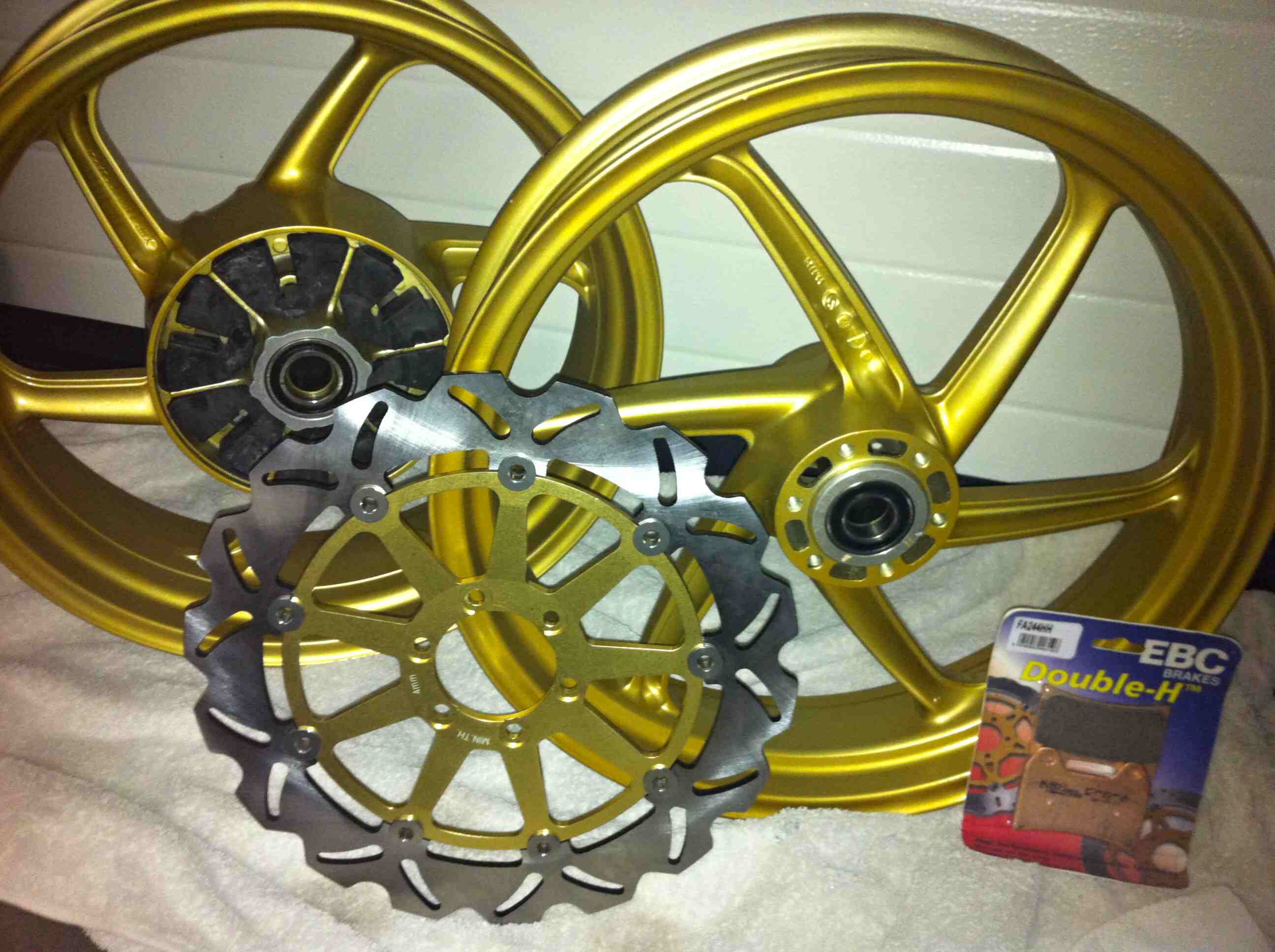

I drive the chinese wave disks, 5.000 miles (not km :) now. No problem.
Btw, almost all companies have their goodies forged in China

Well I've been and gone and done it, a set of front discs for £123.00 delivered from China. Got the wavy ones, what the hell.
They have 8 sets left.
I'll let you know the outcome.

Post by Chips1953 »
Well there we go, they are on as the vibes were getting worse, esp' in the wet?
Fantastic, no more lurching to the lights, and excellent stopping.
No issue now, it's solved.
I went to Penrith Motorcycles to have them fitted, and Anton did an excellent job, also setting up my suspension for me whilst I was there.
Many thanks.
