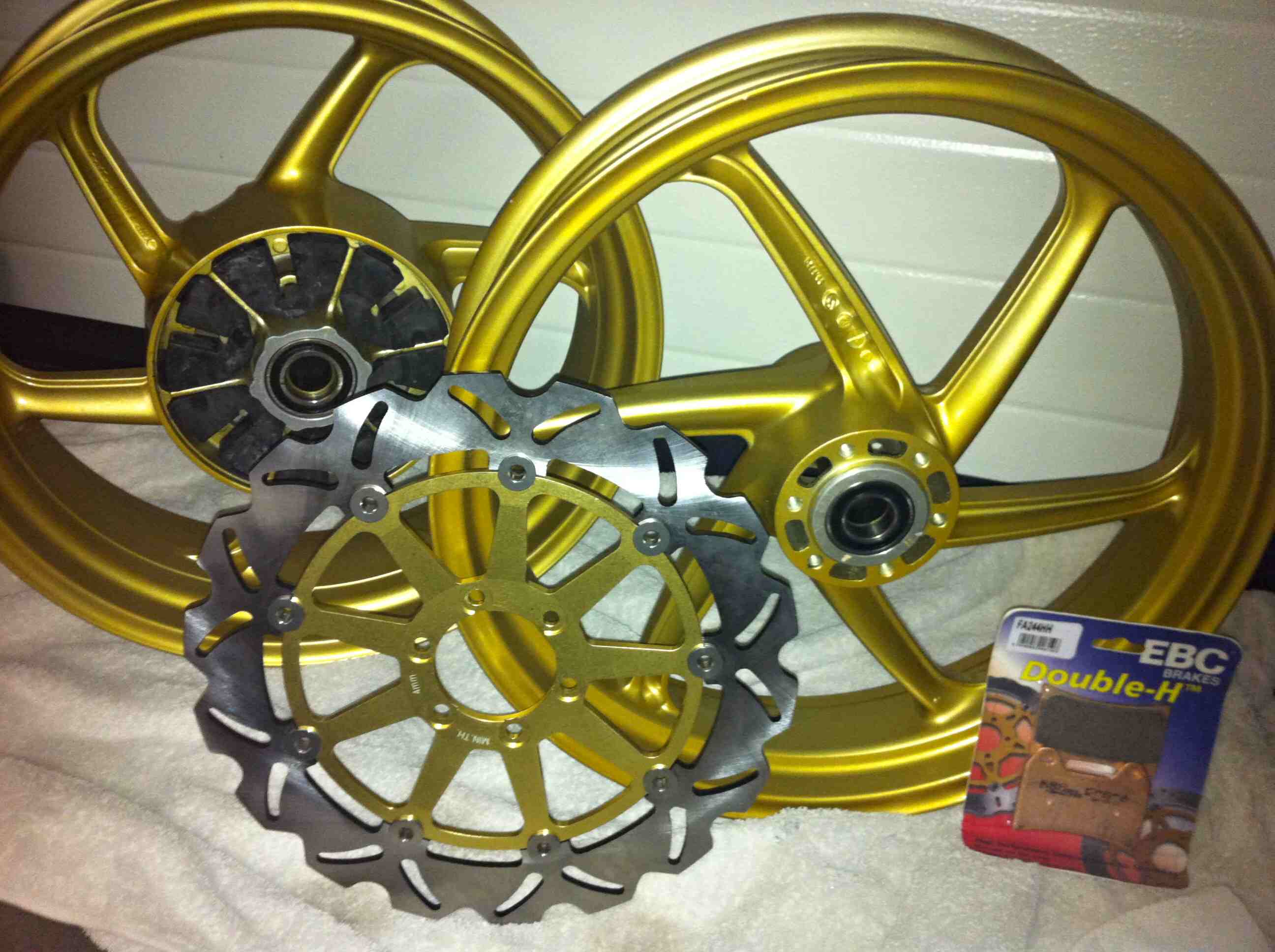

I drive the chinese wave disks, 5.000 miles (not km :) now. No problem.
Btw, almost all companies have their goodies forged in China
wieltjes klein.jpg (186.96 KiB) Viewed 25236 times

Thanks for that information, much as I thought. I'll be joining you perhaps not with the wavy ones, but I'll see.
Well I've been and gone and done it, a set of front discs for £123.00 delivered from China. Got the wavy ones, what the hell.
They have 8 sets left.
I'll let you know the outcome.
Cheers.
