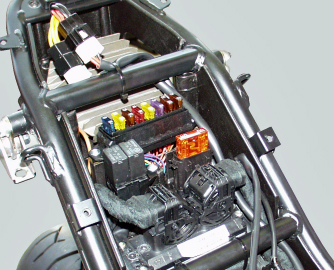

i always seem to have the same error on the diagnostics it reads engine relay s/c ground
where exactly is the engine relay ?

I may be wrong but the 2 relays pictured on this shot to the left and below the fuses are what you are after.
The picture comes from page 68 11/06 of the Manual.
If you don't have the manual then either Twisty, DaveH or Corsaro Chris may help. The manual uses full colour plates and good description.
The front 3 relays are to do with lights etc. ( behind the Cupola).
With my Corsaro I have found cables with friction wear, so perhaps you have to investigate the loom. New relays are available, check out the compatibility list.

- relays.jpg (132.49 KiB) Viewed 9599 times

the 2 relays look fine and cant see any suspect wiring
away for couple of weeks now when back will see if it throws up fault again

Cleaned up relays and put some miles on it
No more errors so fingers crossed
