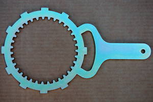

Benelli clutch Holding Tool- fits Wet clutch models
as the benelli clutch is the same this will fit the morini 1200's, unless it has been changed for later models
http://www.ebay.co.uk/itm/Benelli-clutc ... 19d5b7365d
£18 incl postage on ebay
benelli clutch tool.jpg (9.68 KiB) Viewed 8808 times

twisty wrote:Benelli clutch Holding Tool- fits Wet clutch models
hi twisty,
have you already used this tool? does it fit?
günni

the morini clutch is the same part as the benelli 1130 (wet clutch) , i've had them in my hand to check.
The only thing wrong with the clutch holding tool is it requires the clutch plates to be removed so that the splines on the tool fit the grooves on the clutch.
Otherwise a cheap investment.
