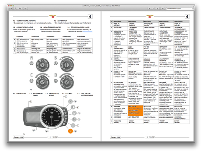

The Injection Warning Light is called as such in the Manual. The injection system is why the ECU is there so I guess it is the device which controls the operation of engine, fuel and all associated sensors.
I have tried to attach a photo but the "Board Attachment Quota has been reached". Anyway it's there in black and white in the manual. Injecton Warning Light.

Re: Injection warning light
Thanks Steve. As you can see it works.
