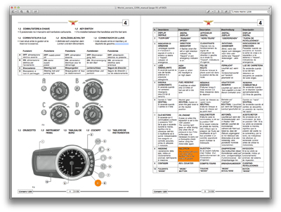

Having spent some time checking through the Manual I have found that I may have a defective ECU.
I have swapped the ECU for the spare I got from 3X on purchase, the one that is supposed to be for Termi's.
Fault now cleared.
I will try to reflash the ECU and see what happens.
The Injection Warning Light is called as such in the Manual. The injection system is why the ECU is there so I guess it is the device which controls the operation of engine, fuel and all associated sensors.
I have tried to attach a photo but the "Board Attachment Quota has been reached". Anyway it's there in black and white in the manual. Injecton Warning Light.

Re: Injection warning light
Posted: 13 May 2014 21:14
by Chips1953
Thanks Steve. As you can see it works.
Console details copy.jpg (115.75 KiB) Viewed 18309 times
