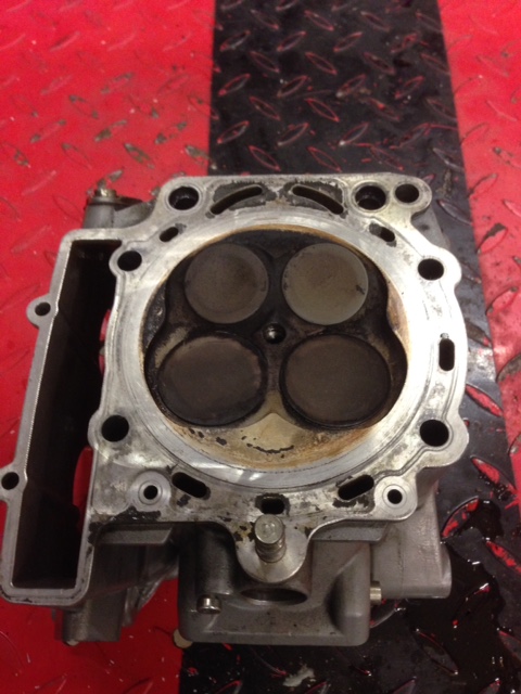

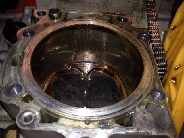

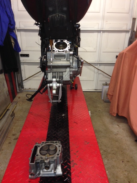

Got the head off this afternoon and found that the valves, piston crown and cylinder bore appear to be unmarked. Fortune saw to it that the valves were closed when the chain went.
I knew it was running a bit rich, but not that rich. Fuelling adjustments required.

Great news that the valve gear & cylinders are in good shape...you're in with a fighting chance now! Give me a shout if there's a way I can help.
