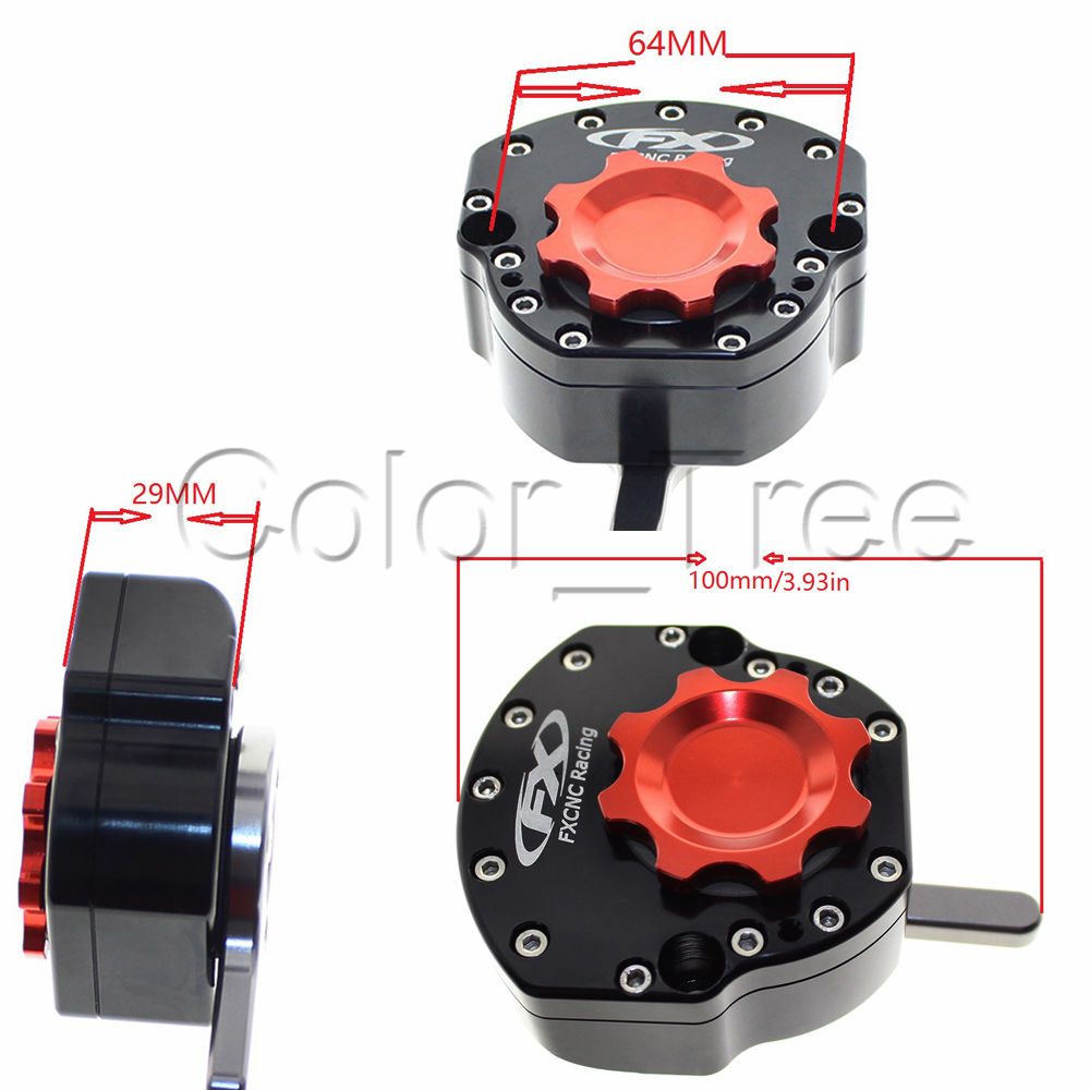

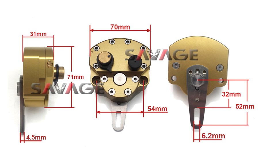

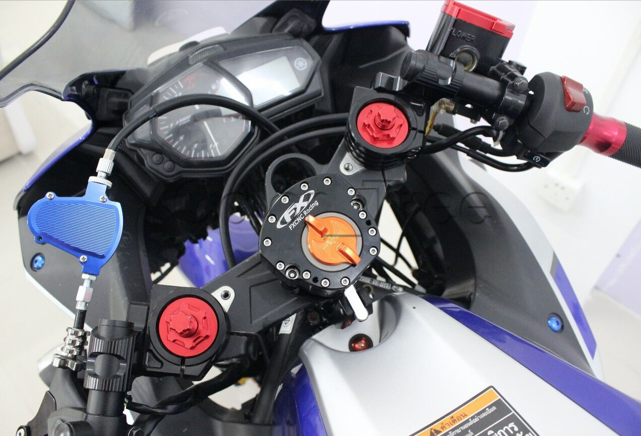

Hi everyones. I found its device. CNC Adjustable Steering Damper from China. Price is 100 usd. + -, There is three or four modification, copy of famous dampers. My mind is busy its. But construction ours Corsaro not fit for same. What do you think about? Is there possybilities to mount its on Corsaro? In thise week i found one way. Black model has same distance beetween brakets bolts, but black item has different centre line between main centre and centre line its bolts. But body has some place for different drilling. If drill new holes, fit our upper travers side, and cut original wheels bracket and place its over damper, what think about? You can look for on aliexpress wit words CNC Adjustable Steering Damper Motorcycle Stabilizer.
Guys, maybe among us there are real engineers who will use their knowledge and offer a version with minimal homework? A? Is there anyone else on this forum with smart brains? Or are you in Europe only know how to make purchases in stores?

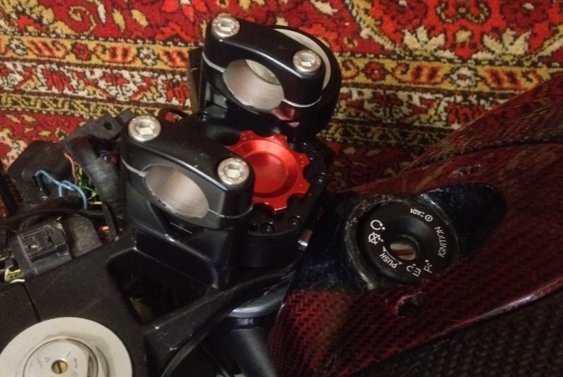

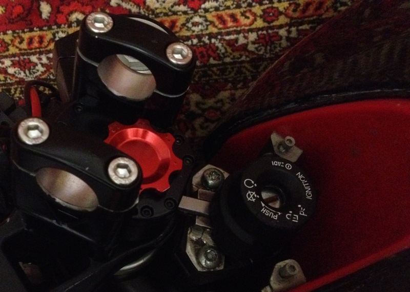

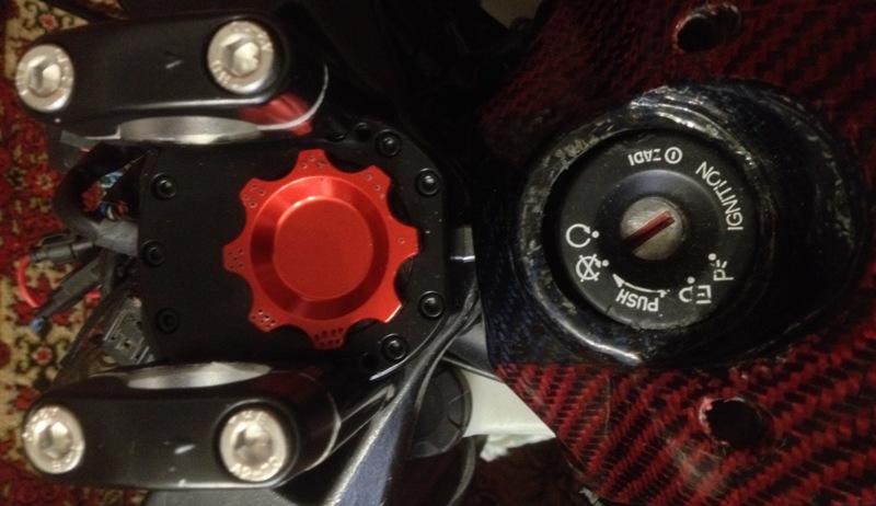

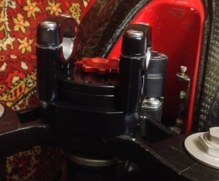

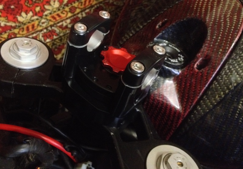

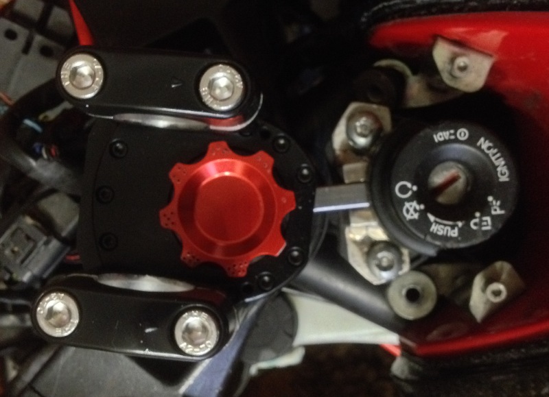

Hello everybody. Continuation. This device was purchased. Since our motorcycle does not have factory adapters, I decided to do it myself. See what happened as a result. The steering wheel was raised a couple of centimeters to place a damper under it and between the traverses. The locking plate easily became on the ignition lock. It was necessary to file a little protruding details. Decorative
