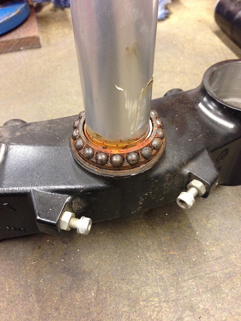

Yes I see what you mean about the manual/parts diagram ambiguity. In the manual, the picture just down the page from where it describes the 'rubber gasket', it does appear that there is a dust seal fitted below the washer. I reckon they must mean this. Maybe they either missed it off the exploded diagram/parts list, or possibly started fitting one after that document had been produced?
I replaced my head bearings a while ago, you can see the rubber edge of what appears to be a dust seal fitted underneath the rusty knackered bearing...
I used taper rollers which came with the dust seals included so didn't notice the omission from the Morini diagram.
