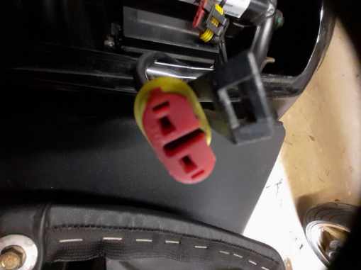

I apologise for what is potentially a dumb question, but what is the name/type of lead I need to connect a trickle charger to the battery charging plug on a 2008 Corsaro?? Thanks in advance!! :?

Is that the ECU point? There is a second plug with two pins on mine.

It's a great pity that Morini didn't think it through when, alone of the brands I know of, they provided a charging lead but terminated it beneath the seat. One of the first jobs I do on any new-to-me bike is add a fused flying lead, with superseal socket, straight from the battery that's accessible without removing anything at all. Of course, it also means there's somewhere easy to connect a satnav, etc., bearing in mind it isn't switchable via the ignition.
