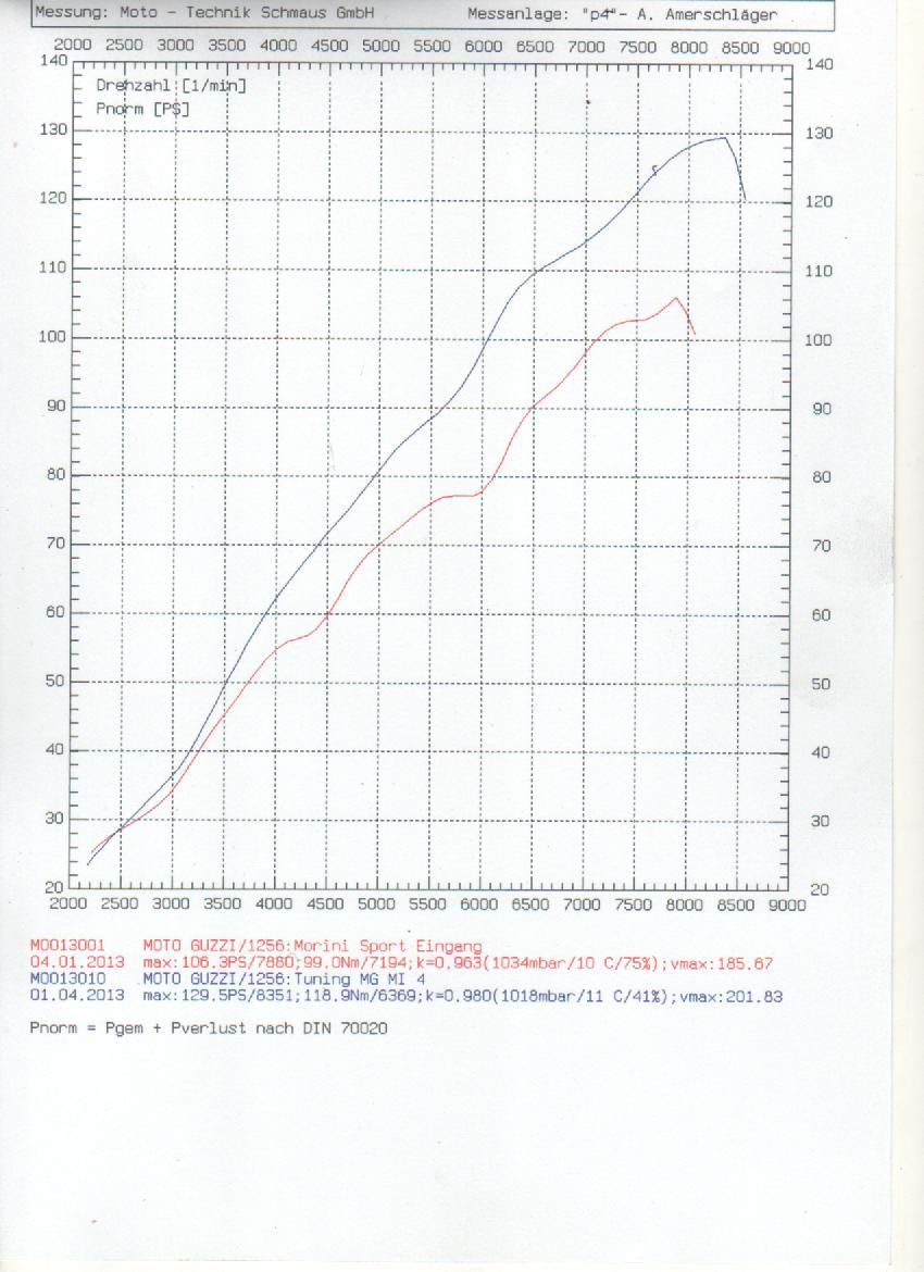

The gas tank will have a capacity nearly 14 L.
We know it exactly after building.
The fuel consumption will be 5,5 L up to 7L at full open Throttle.
The HP will be arround 130 with the Stock 9 1/2 engine.
This is depending of AFR based autotune and datalogging system.
This programm calculated the fuel consumption and rewrite
the fuel relavant maps to more HP and less fuel consumption.
Hope to get 4 to 8 PS extra hp with a complete custom exhaust system,
head porting, exactly the same compression ratio on each
cylinder head and machining the valves and seats.
Even cam timing will be change to exatly the same for front and rear.
This is only blue printing and not big tuning.
